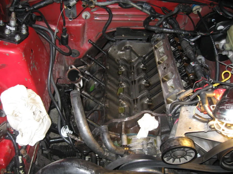

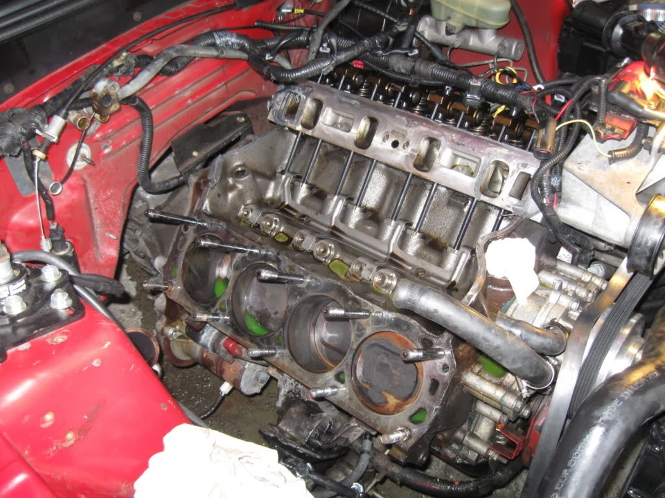

Here is some progress I made today. I'll probably make a build thread as well.

Good luck, Venom. Looking forward to the build thread.
