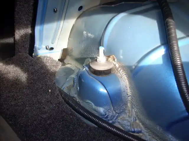

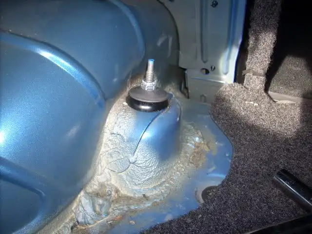

I installed new rear shocks on my 95 Gt and wondering how tight should the top insulator nut be tightened to? Should the nut be tight where the rubber insulator looks like a pancake? Or is that to tight?
Should the rubber insulator be this tight? The rubber insulator looks flat as a pancake. Or is that to tight?
Or should it be this tight? The rubber insulator does not look like a pancake
I use number #1... i go untill it smushes and you get some resistance... Im sure there is a torque spec though.
Torque spec is 25-34 Lb-Ft
It will squish to about the same diameter as the washer. It will look like less than the first pic but more than the second.
