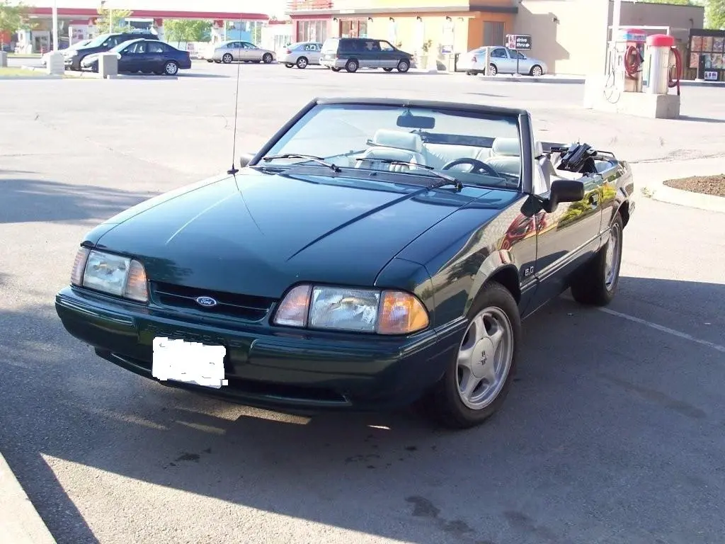

Thanks for the reply guys! Here's a shot of my baby..
