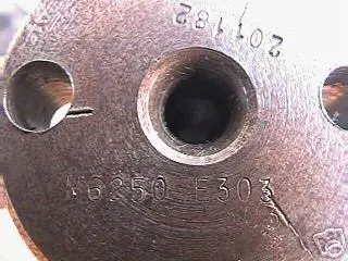

O oneslo5o New Member Dec 21, 2003 4 0 0 Jul 24, 2006 #5 Jul 24, 2006 #5 FRPP cam part number It will be stamped on the end of the camshaft (see pic) Attachments e3_1.webp 17.3 KB · Views: 159
