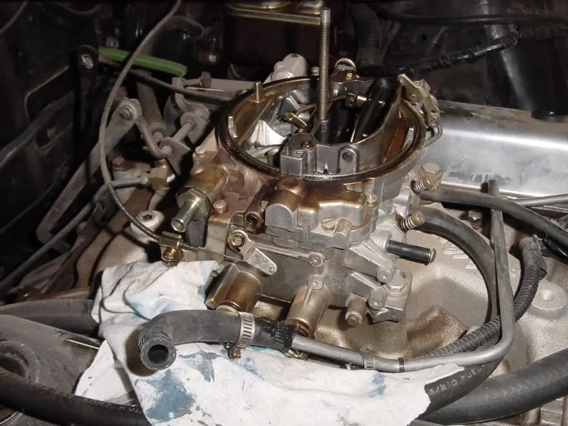

Hi,
When I was running my 1405 EDDY, I used that very choke cable. The pull was mtd. in pre-drilled hole just below the ignition. From there the ca was routed to exit the firewall, pretty much, in the center and in direct line to the choke lever. The first and current pic shows the ca exiting the firewall and going to the choke lever on my Webers. This routing was the same for my Eddy 1405 (second pic). Notice the ca exiting just under the center of the export brace and travels just past the fuel line entry at the upper portion of the pic.
I'm not sure why one would have the ca routing from the fender side?
