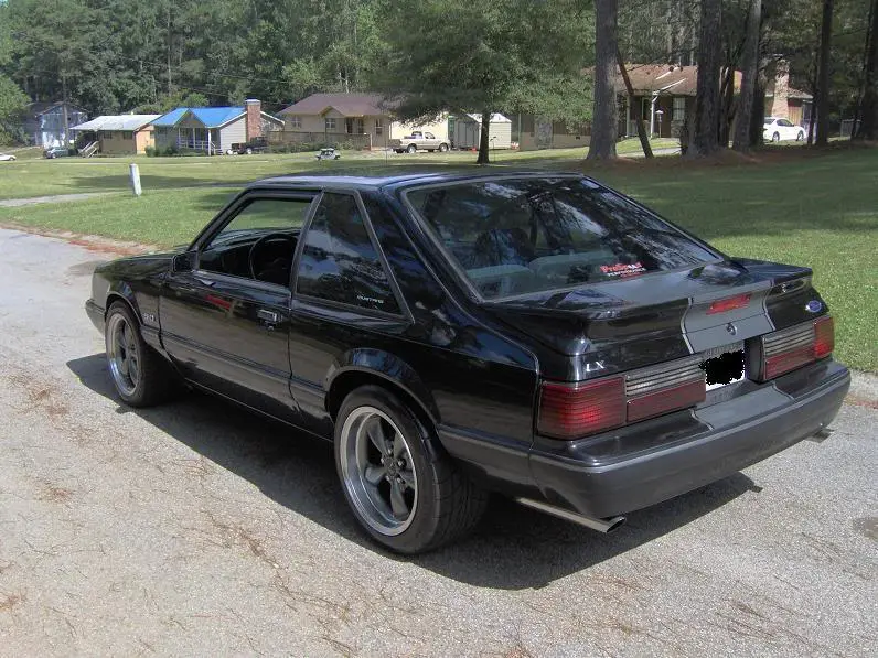

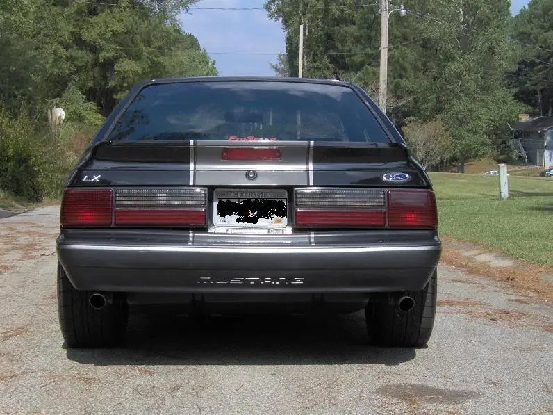

Woodrow said:
Use the stock fox lenght axles and ditch the quads, thats all it took if i remember correctly.
Awesome thanks!! :hail2:
so no axel swaps or anything like that?
Did you have to roll the fenders at all?
What is the back spacing on your rims and how much room do you have?
