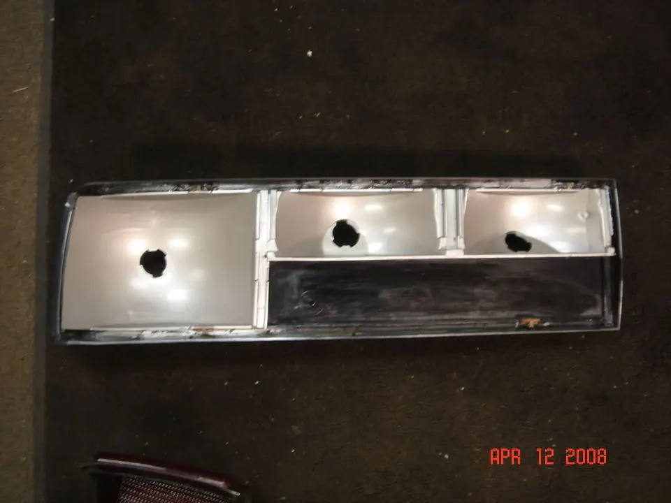

I am repainting the inside with Chrome spray. I have polished them and they look great. I need to know how to seal them back up. Can I use butyl rope seal like you use for a windshield. I want to make sure it is not going to be permanent, just in case I have to pull them apart again in another 22 years. Thanks in advance.:shrug:

heat them up with a blow dryer and gently pry them off. FWIW I have taken the lenses without heating them up and not broken one yet, but I am not sure how much of that was luck.
Yep, get a heat gun (not a hair dryer) and heat them up evenly. Don't get too close of you will melt the plastic. Evenly heat it up, evenly pull the lens apart. Start by lightly prying with a wide scraper tool or putty knife then get your finger tips in there and work them out and heat as you are pulling. I've done it a couple times.

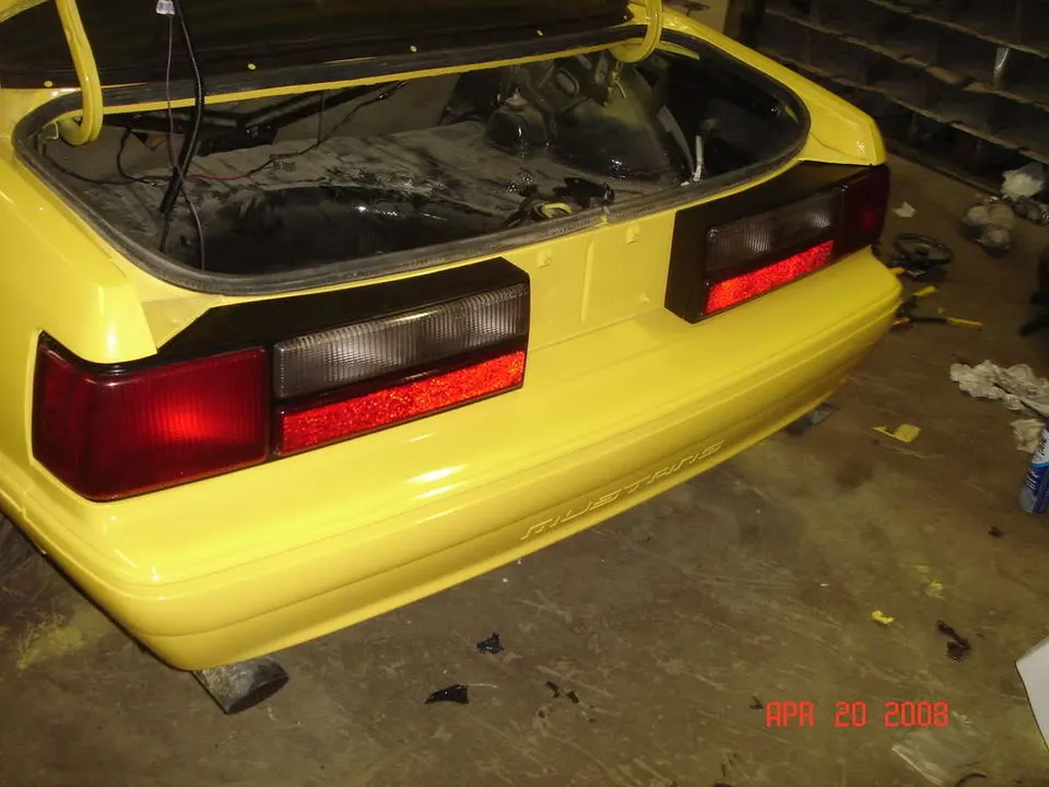

Painted silver backings inside, black trim repainted flat black and the lenses were wetsanded with 1500, 2000 and buffed to gloss.
Thanks to everyone for the replies. I had considered the 3M weather adhesive. I guess I did not notice the metal tabs you are talking about.
I did not have any problems pulling the assy apart. Just slow steady pressure and they came right apart. I do know that is some gooey stuff they use at Ford. I bought some Duplicolor Chrome spray paint. I will be trying it this weekend. As far as polishing the lens, I cleaned them up with Purple Power and made sure not to let it stay on to long. I used Mequires PlasticX and a mini ball to buff them out. Then I just waxed them with some Carnuba and they are good as new.
