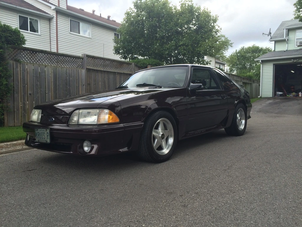

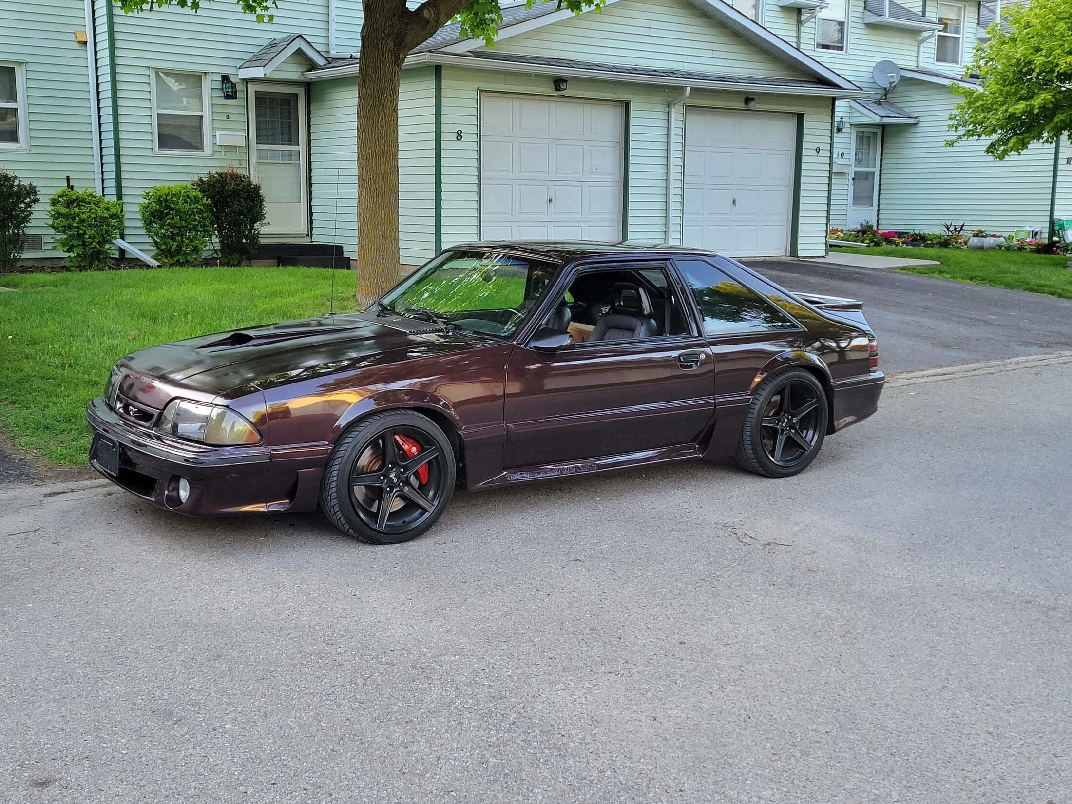

How she sits now...

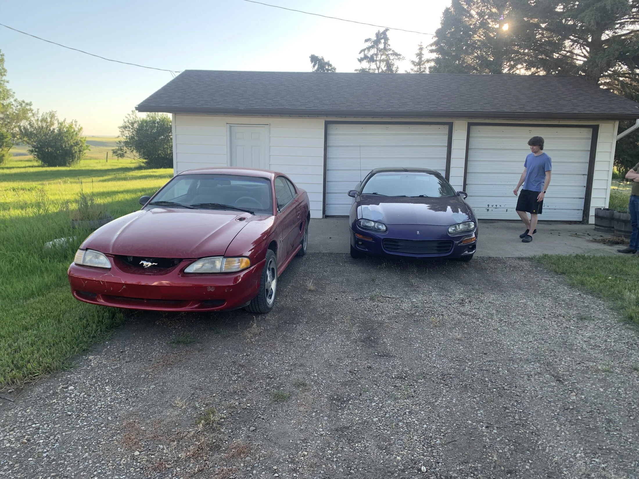

That’s a good looking car I love the dark purple paint. Would have got a foxbody if they weren’t so expensive. My car looks 10x worse ha was sitting outside in a gravel storage lot for years because of it was a v6 with a blown head gasket but becuase of that it had low km good bushings and was for real cheap. That’s it but my friends v6 Camaro.

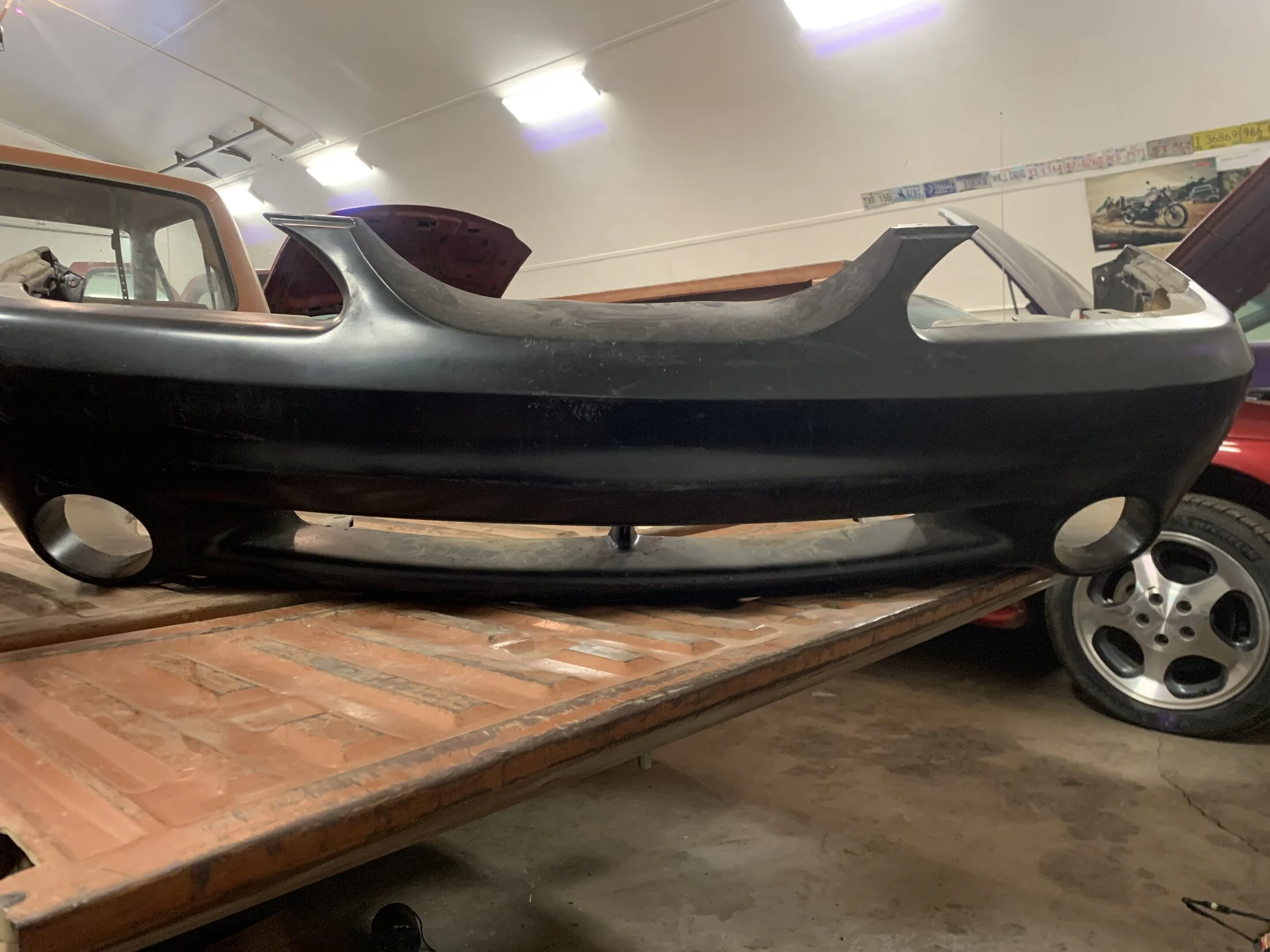

Got an aftermarket cobra style bumper I found at pick and pull that I plan on painting and putting on the car later

Nice start. I like the cobra bumper idea too.

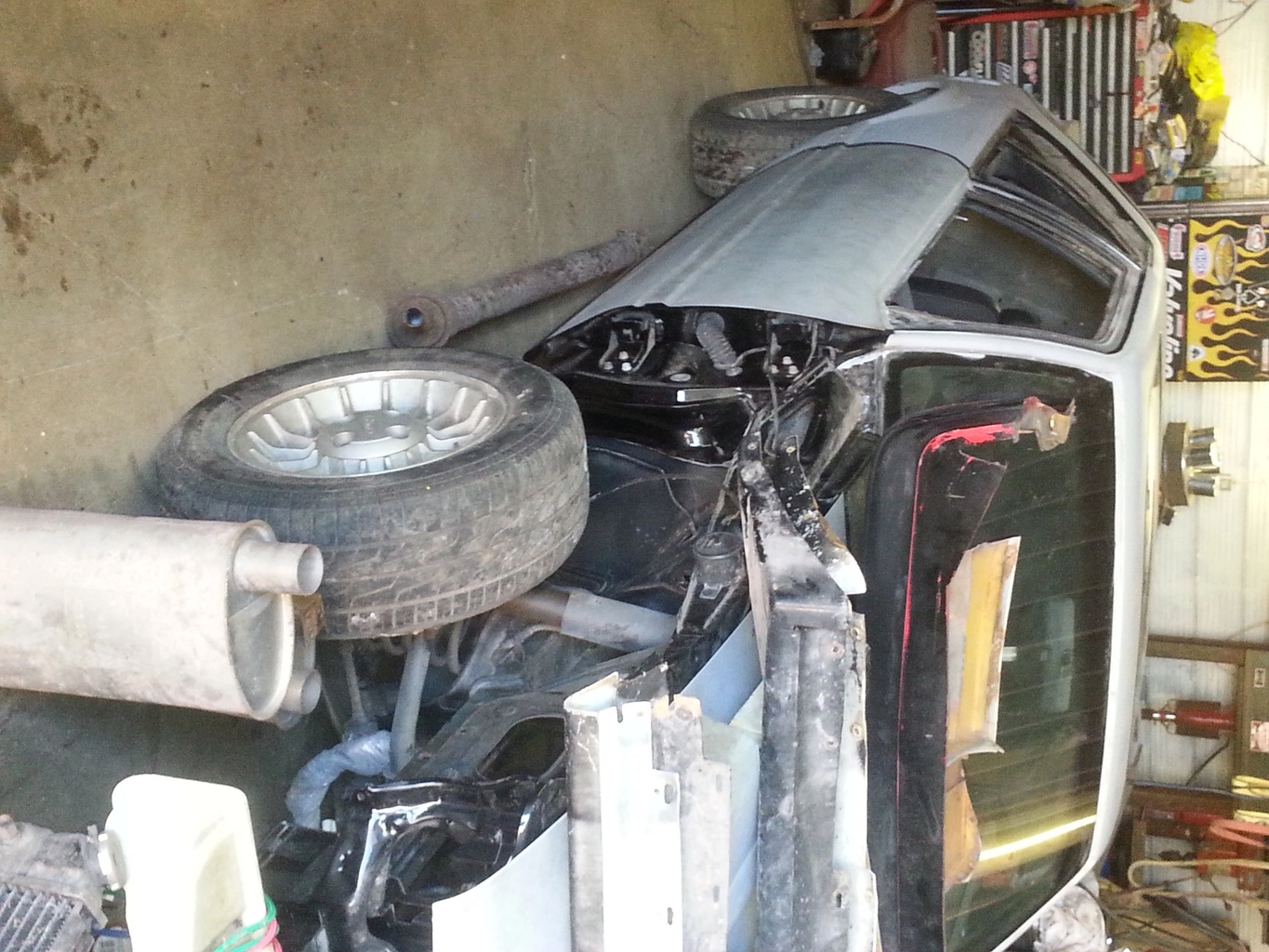

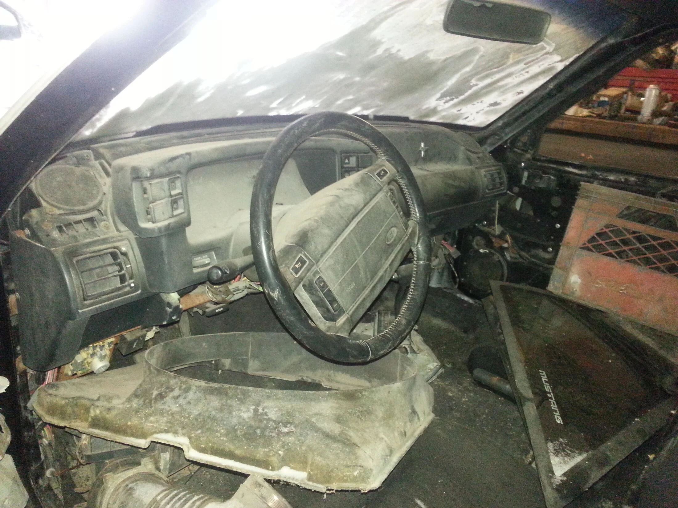

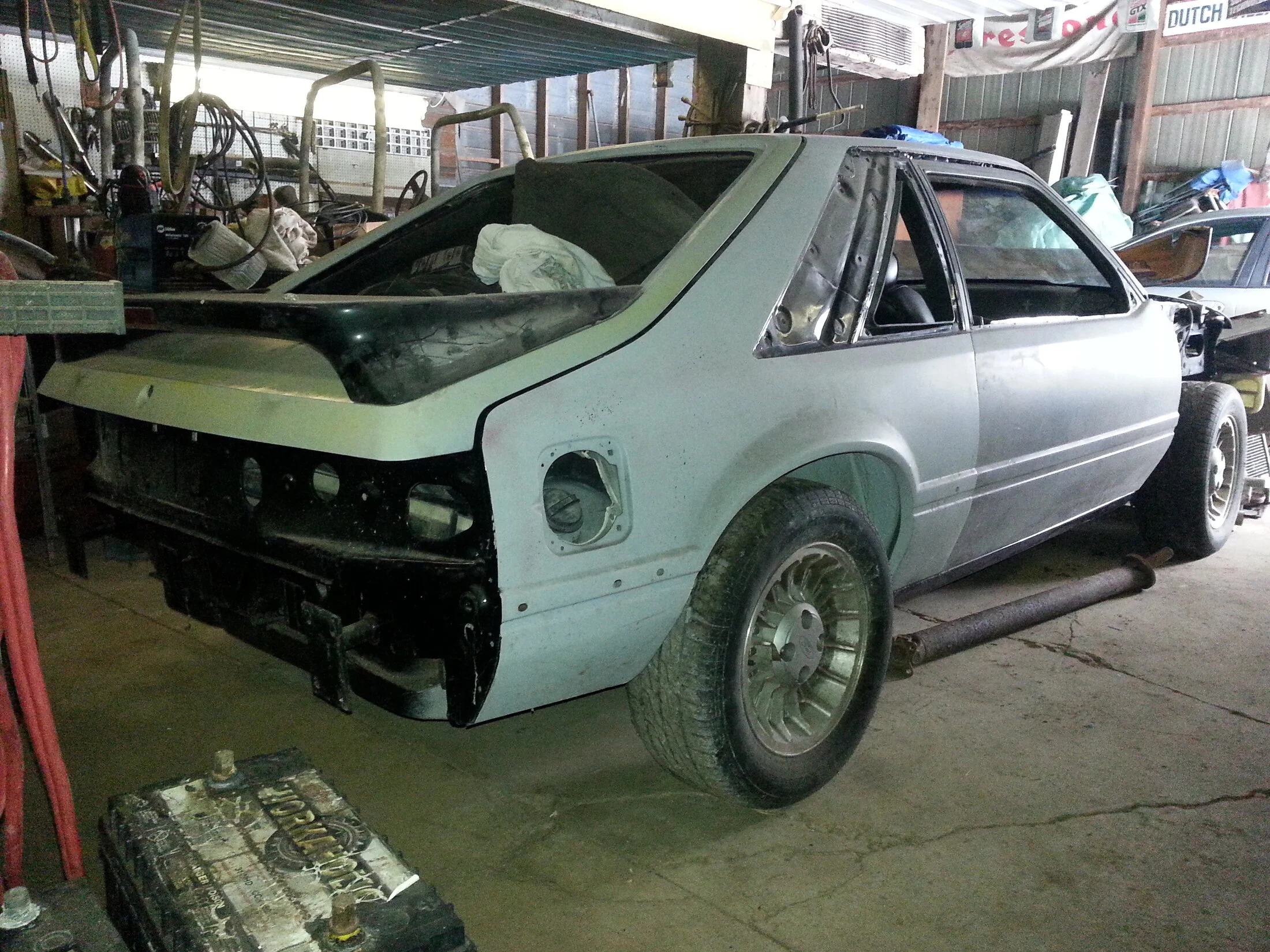

Here is what mine started as in 2015 when I bought it.
I paid $1500 for a 90% complete car that was disassembled. Factory black on black loaded automatic car.
I modded chassis and suspension as I put it back together.
