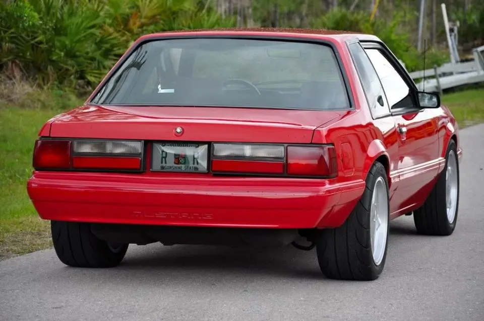

This is the exact wheel and tire package I've got on my black notch and it looks SICK!!!!

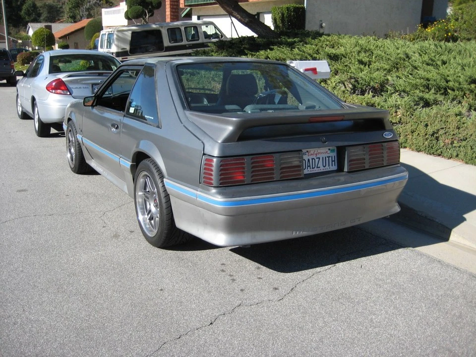

I have the same combo on my 88 GT and it is bad ass looking but I have to agree with Riverart as I to wish the fronts were 8" wide. I would love to post some pics but I am computer challenged right now till I can get my laptop fixed. Thank god for work computers so I can get on at all.
