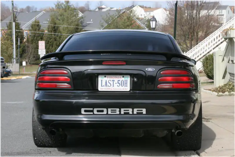

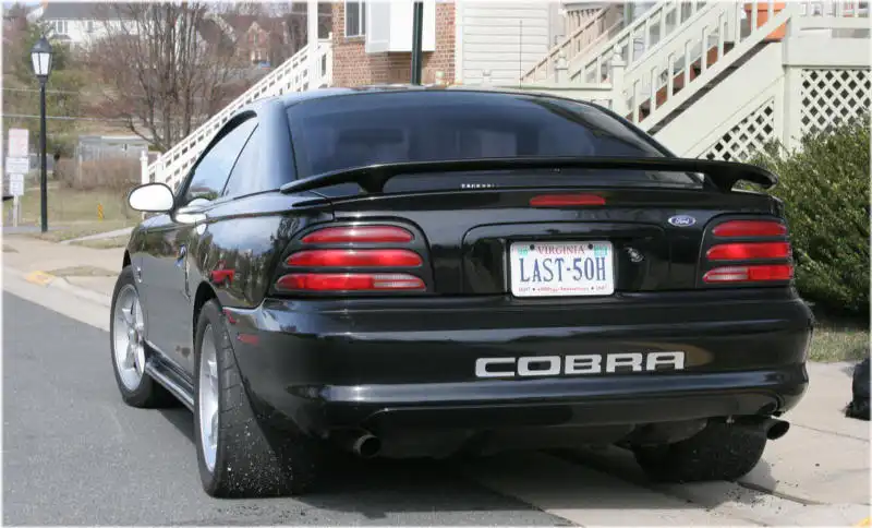

IMHO this is how the ass should look.
BFG D/R 315/35-17 10.5 rims 1.25" drop
