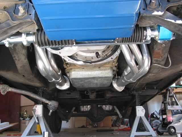

Next component will be my shorty headers...sniffff...the long-tubes have to go...sniff. I have gone on record here in the past saying that the Headmann 351W swap headers clear an AOD. Maybe you'll recall this pic...
Well, my exhaust man did not agree. Actually what he said was that he can make them work but it would look like crap and be scraped off at the first speed-bump I came to. Anyhow the shorties will be here tomorrow, so if anyone wants a set of ceramic coated LTHs let me know :D

But knowing how tight the shock towers are for a 351W in a 65-66 I'm not confident enough to tell you yes. Remember, in my case it was not the 351W that made them not fit right, it was the AOD, more specifically the cross member from Windsor-Fox that the headers clear (collectors well in front of) but the primary tubes would be too convoluted and low-hanging in 2.5 inch pipes.
So on a 302 they might fit better (total assumption there) but also might hang even lower (shorter deck height). Top that with the fact that I'm running a 3" pipe from the collector to the "X" and then 2.5" the rest of the way. I'm running a '95 T5 with a crossmember I fabbed for extra exhaust clearance. Shoot me a PM on a price, may we could work something out or I just HAVE to go with a 393 stroker....oh the humanity ;)
