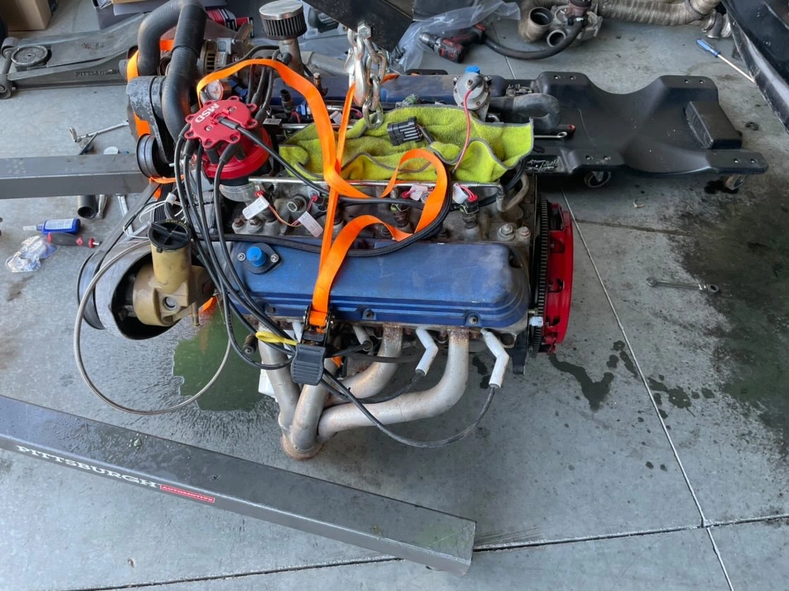

Hello guys, Recently starting working on my 91 Notch with a older HP turbo kit, SVO heads and a Tremec 3550 transmission. The car is originally from Hawaii and spent some time in Vegas. When I originally bought it was sporting a weld drag pack since I have put on a mores streetable tire setup with a set of NT555RII on the back.

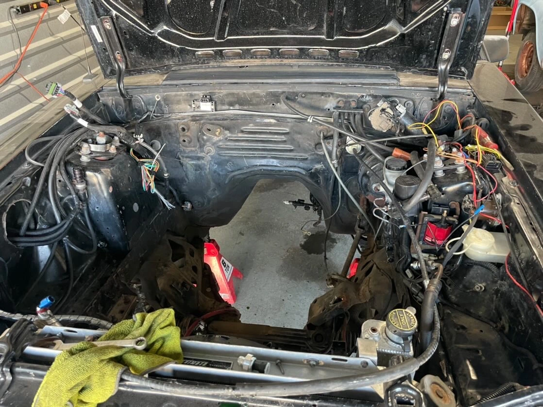

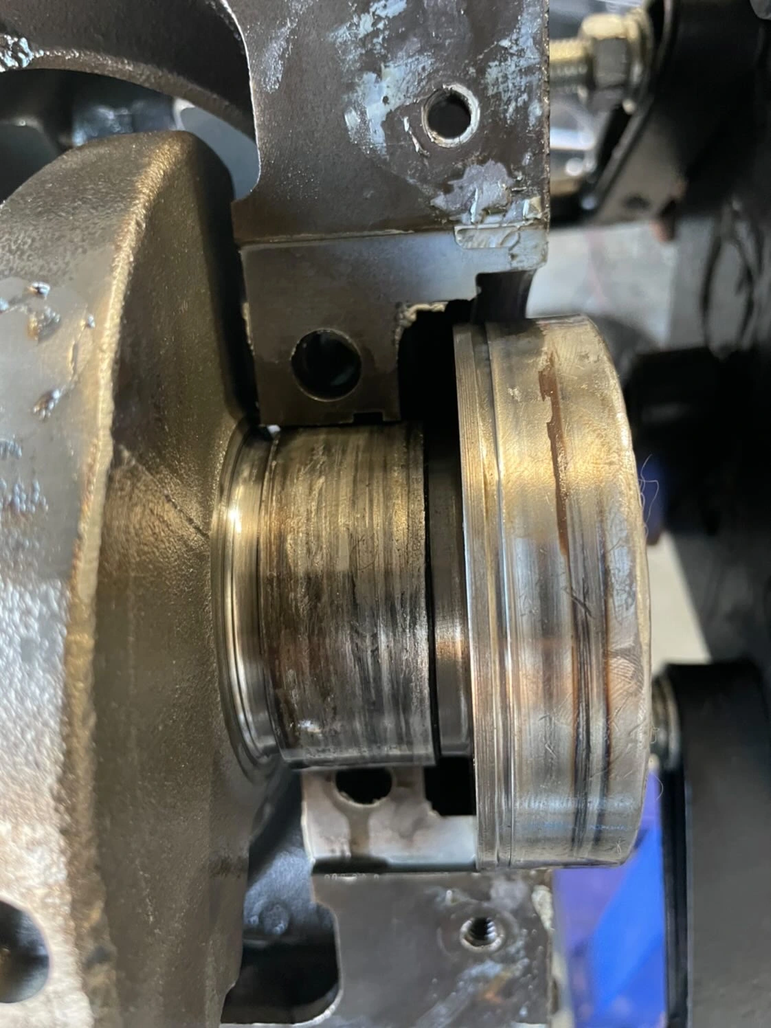

Recently I have had an issue with it blowing rear main seals, I have vented both valve covers to a catch can however it still keeps blowing them. The care is currently under the knife getting a terminator X installed and the motor gone through to find out what a possible issue is.
I don't know a whole lot about the history of the car other then it went 11.3 with an inexperienced driver.

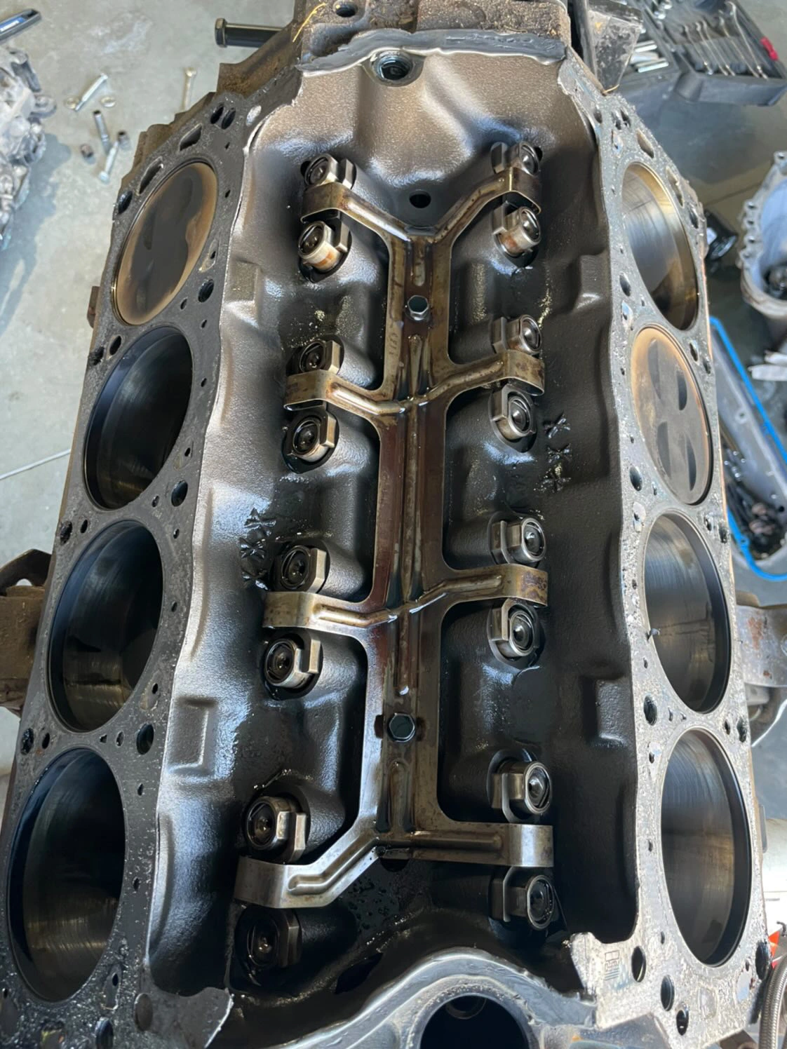

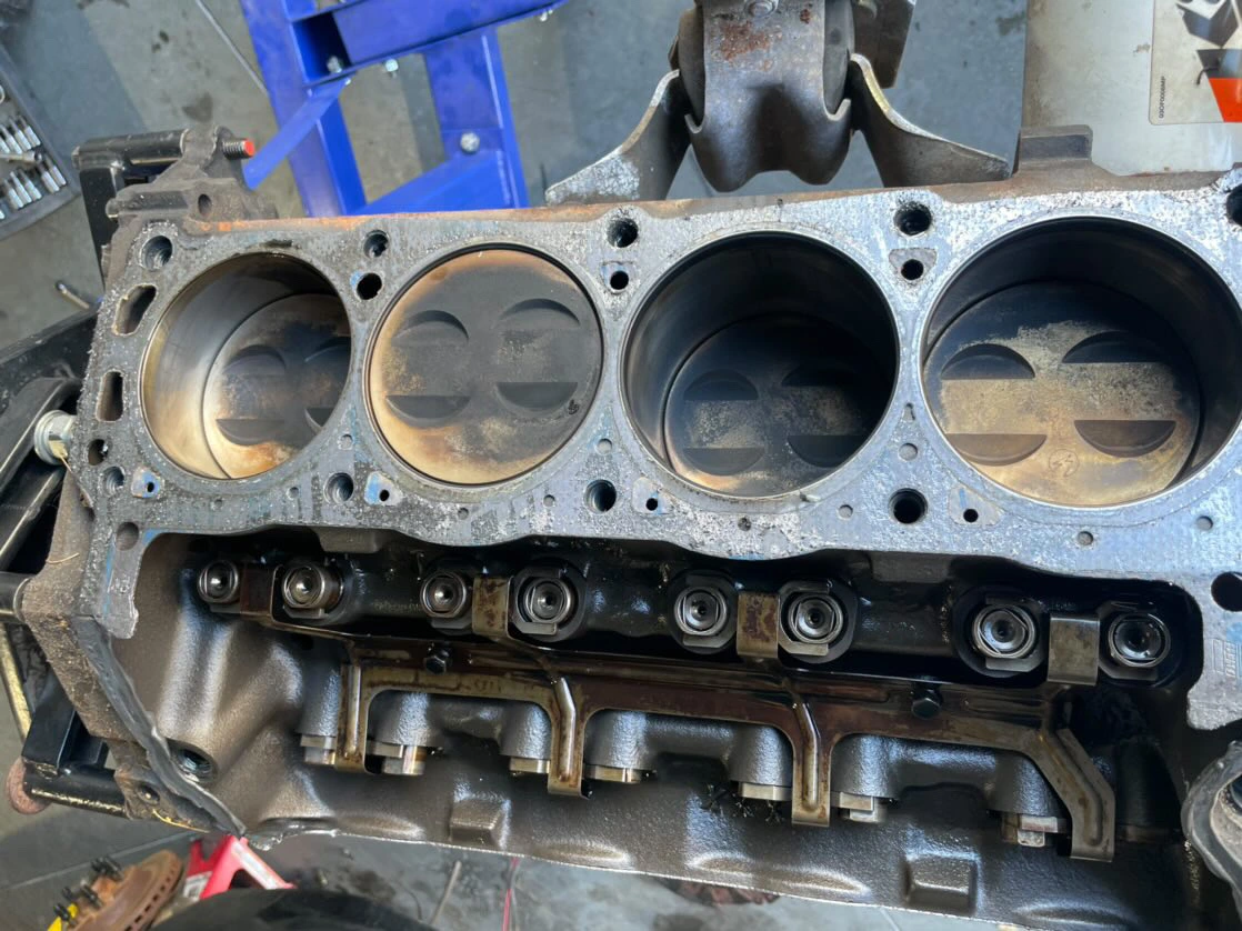

Well gents, tear down complete and we found the reason for the unhappy rear main seal. The rear crank bearing had spun causing hate and discontent. In the process of acquiring a new block and a forged 331 rotating assembly.

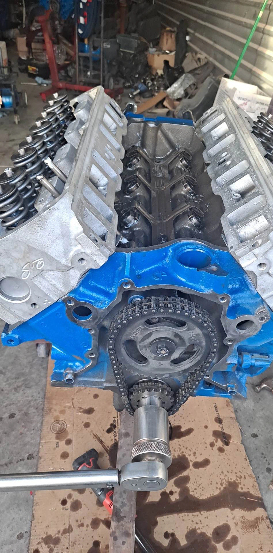

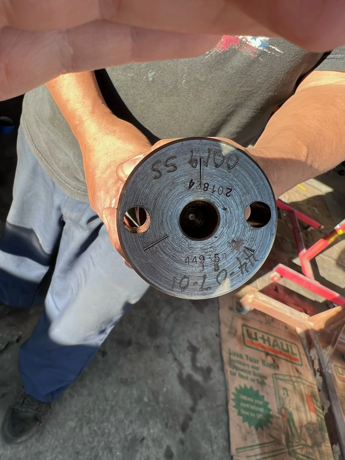

Motor is going together slowly had the heads cleaned and freshened up with new guides and seals. Can anyone tell me anything about the cam that is in it. I have googled every number on it with no success. Having a terminator x installed and need to know something about it. Any help would be greatly appreciated.
You can take a micrometer and measure the camshaft lobes in a cross pattern. Subtract the smaller number from the biggest, per lobe, and you have your lift. You can then look up camshafts that have the same lift as the one you have. A brake rotor micrometer can work but might not be as accurate.
