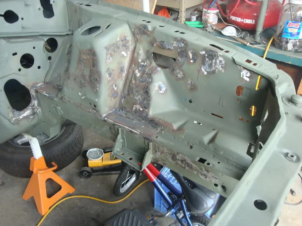

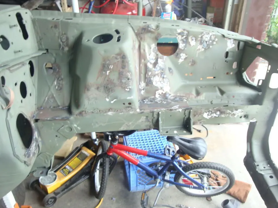

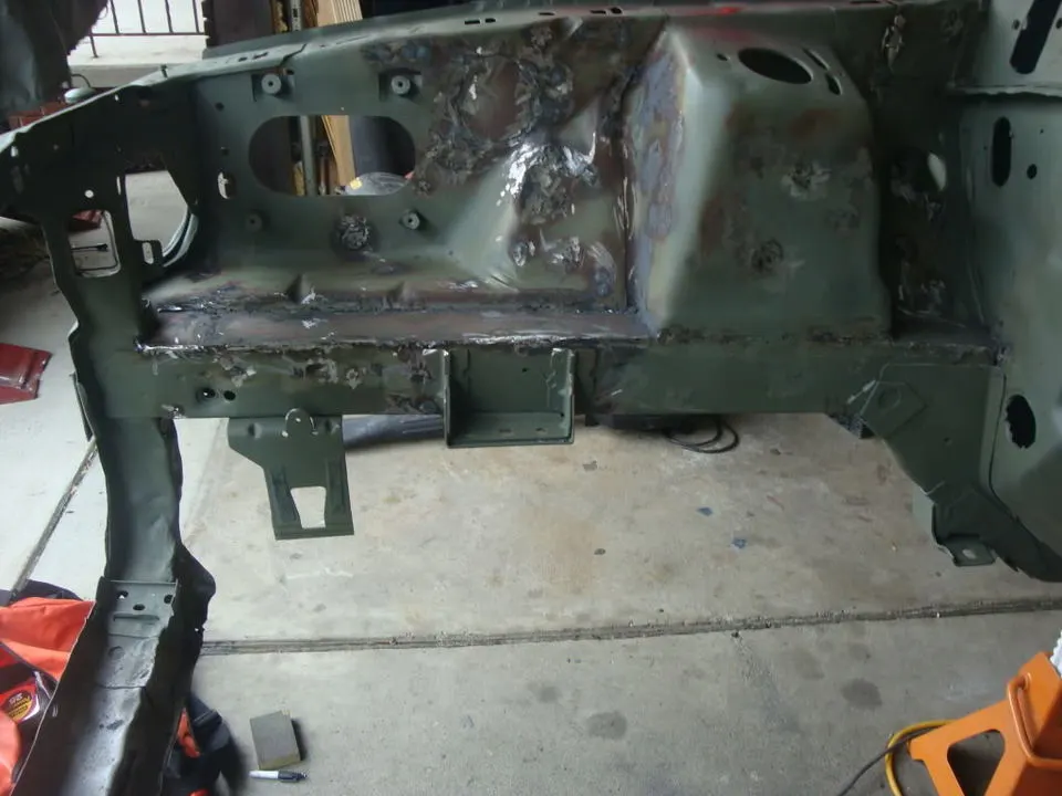

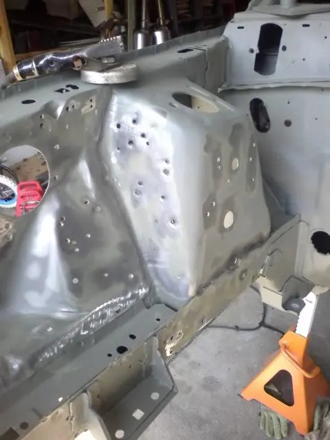

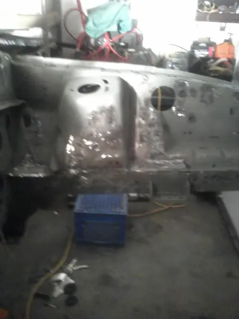

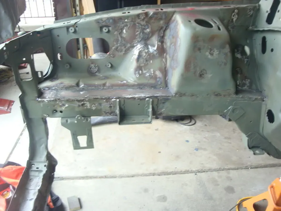

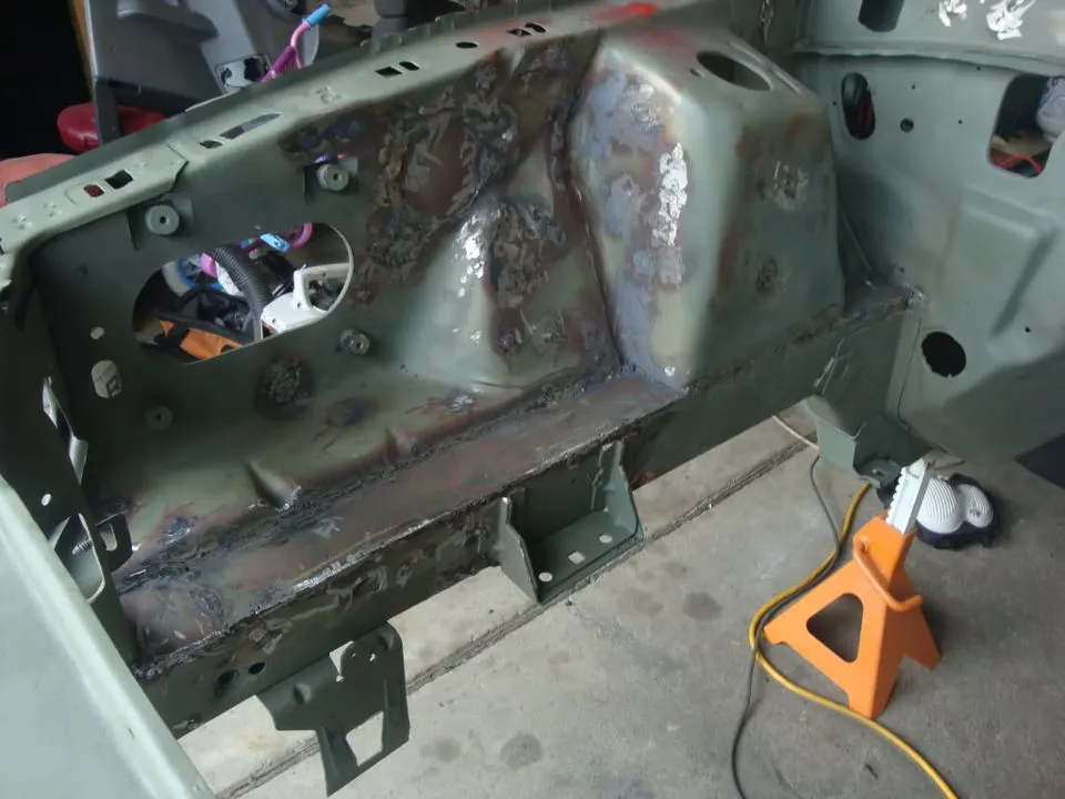

i took an extra day off from work last friday and started on the engine bay these are phone pics .i am thinking of borrowing my neighbors camera i don't think they would mind here are some bad pics

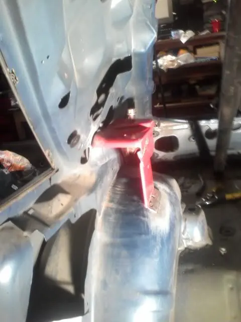

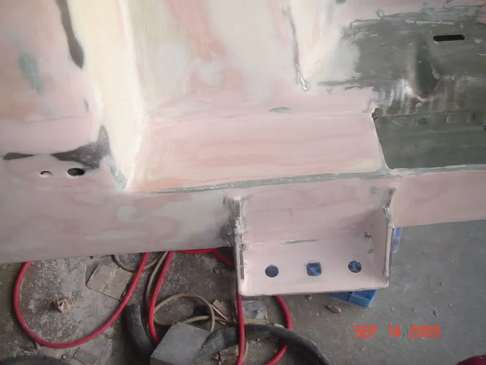

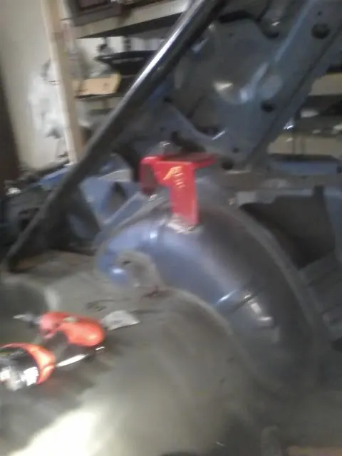

i am going to take some better pics hopefully tomorrow i set up the bracket for the rear shoulder belt . i cut these out of a 1990 four banger and with 2 kids i want them to be as safe as possible.i will be welding these in tomorrow but here is a couple of pics of what i am talking about

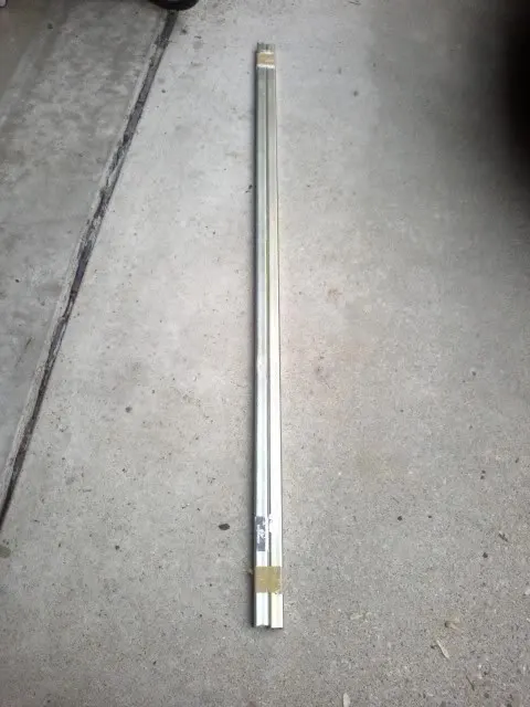

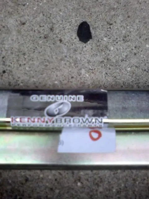

as promised although phone pic the jacking rails but my mistake they are made by kenny brown

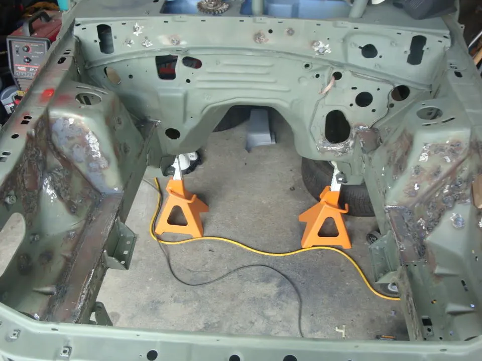

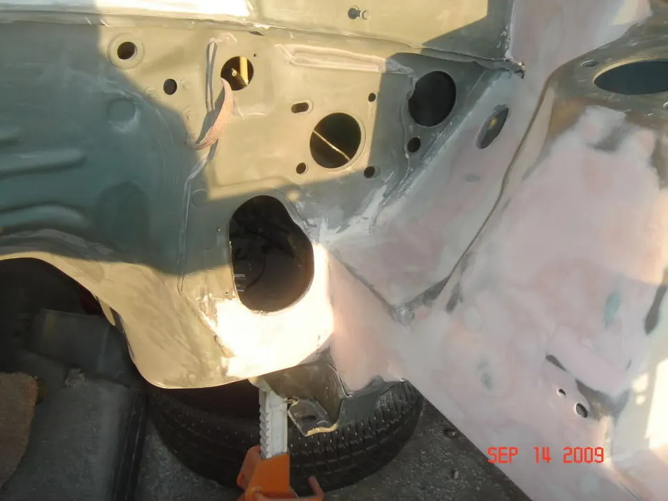

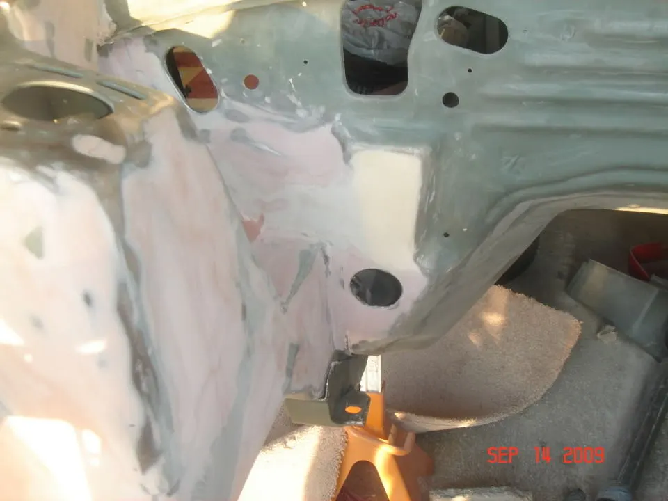

that's what i am doing right now and it sucks i can see why most people say that they will never do it again.i know i will never do it again what a pain but i know in the end i'll be glad i did it .here is where i am thus far

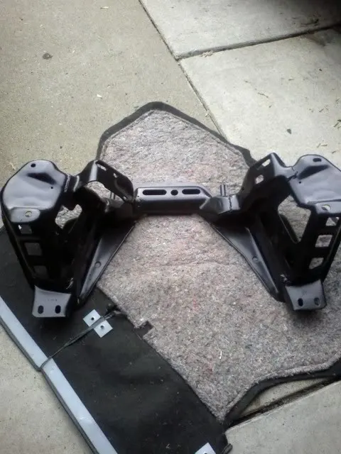

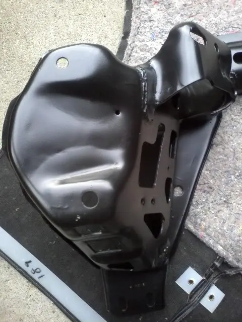

here is alittle progress the k-member sandblasted and powdercoated in black
a close up this thing is BRAND NEW

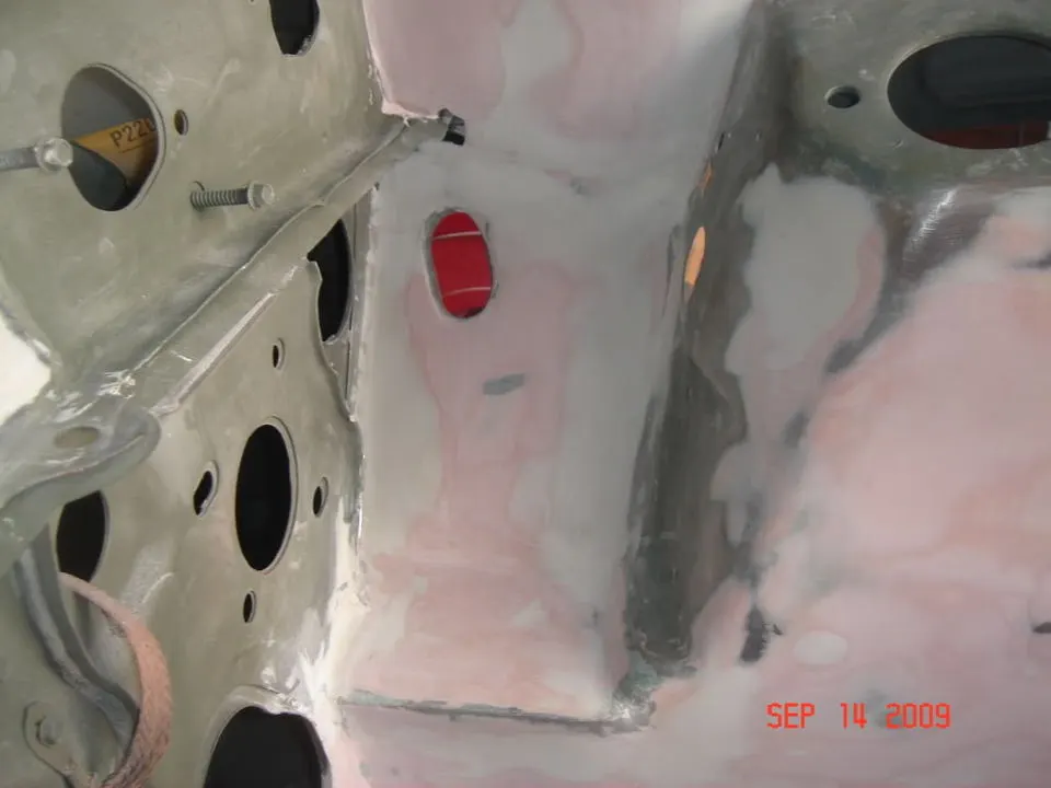

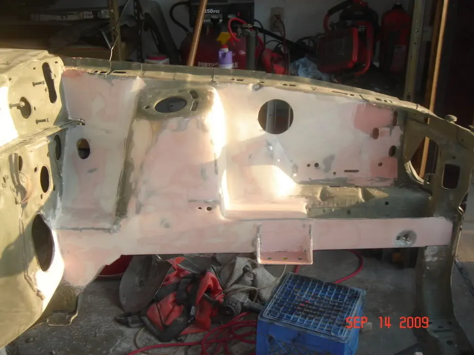

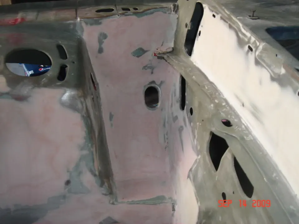

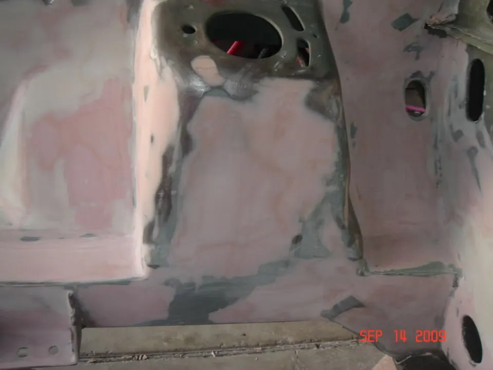

here is the sanded part of the engine bay boy i must have spent a month on this [alot of work ]and i will never do it again lol.
