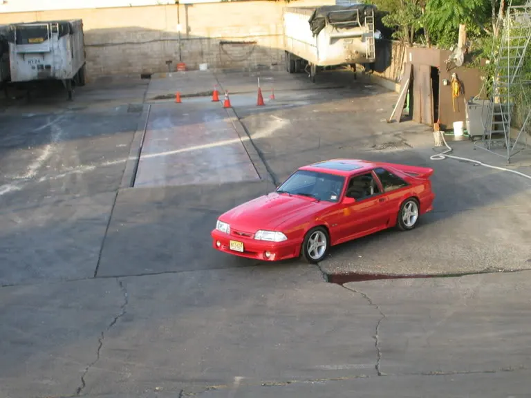

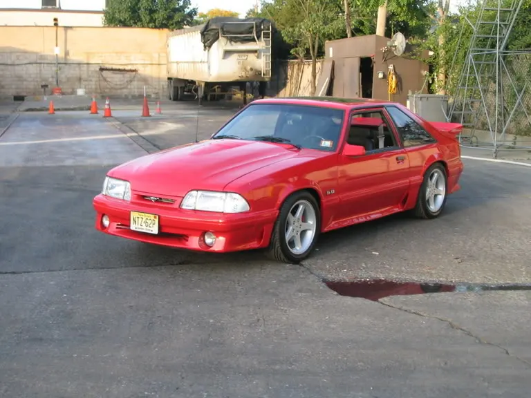

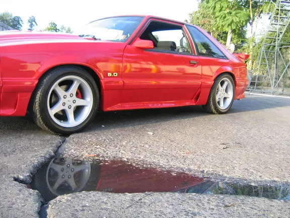

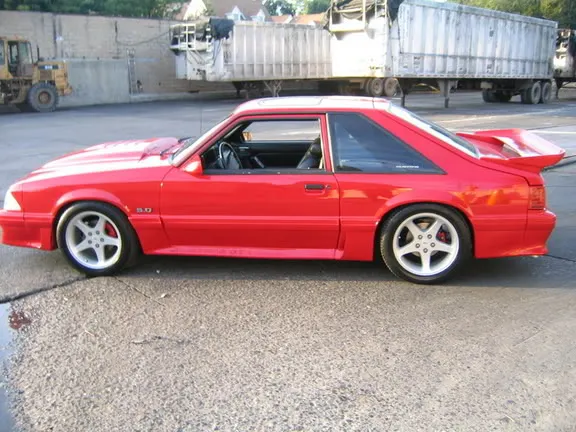

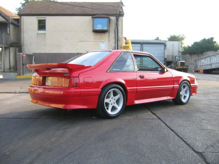

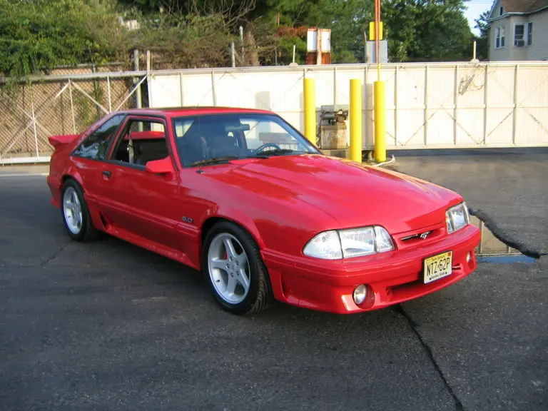

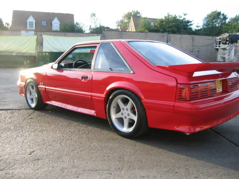

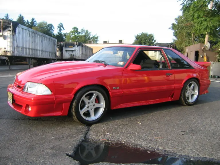

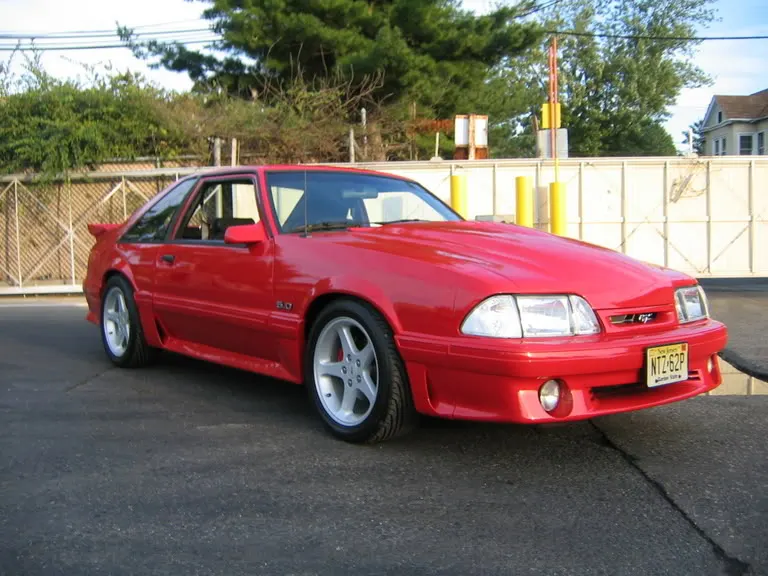

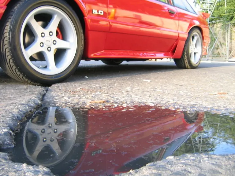

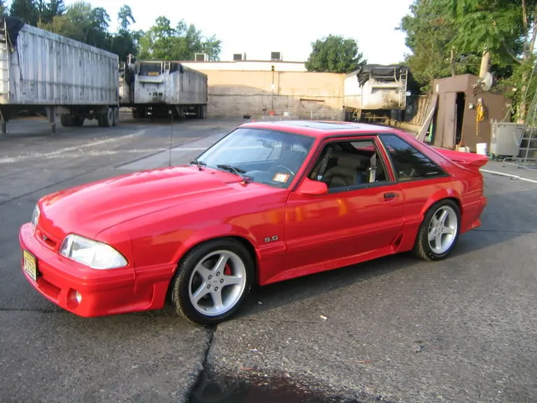

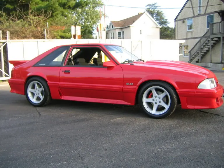

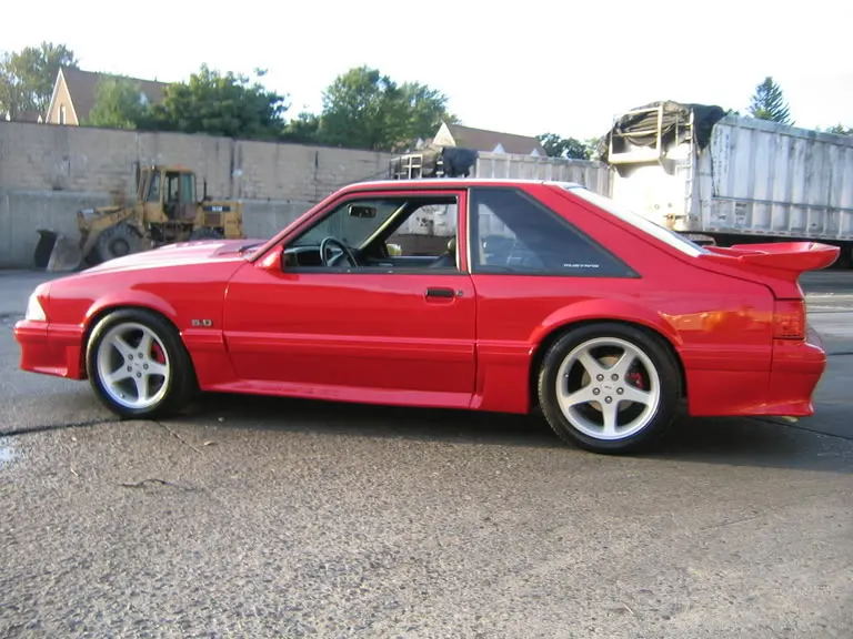

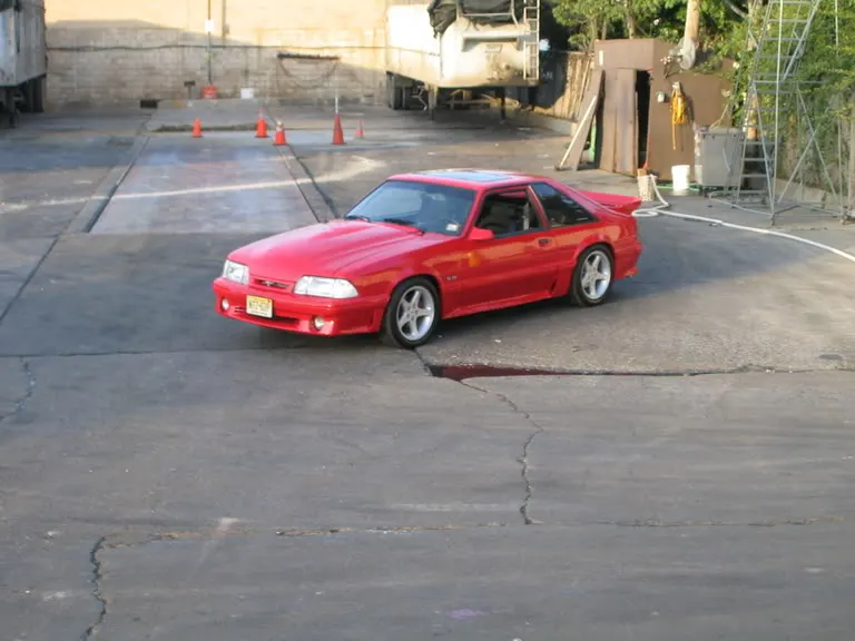

Ok guys forgive the crappy pics and the fact the cars dirty, I just wanted to show you guys the 5 Lug conversion with discs and the Eibach Pro Line Spring instal I just finished,
Was a big job but I got through it,
What you guys think? Better than the Ponys right? ;)

Car looks great man. The cobras are much better compared to the ponys you had. They really accent your new paint job. Do you happen to have any closer pics of the diamond headlights. I'm looking to get some, but I'm still not sure yet.

Nice! I just did my rear disc this weekend. Didn't go 5 lug though. I have my cobra rims sitting in the house waiting for some tires.
You can check the sig for pics. I didn't dare take pictures of the calipers with the rims I have now. Wouldn't do it justice.
