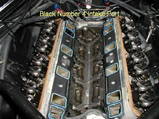

OK - I have now removed the intake, rockers, push rods and lifters. I can see nothing obviously wrong with any of the components but the number 4 cylinder intake port is absolutely black. All others are clean. As everything compression tested good, I don't think that this could be a head gasket issue. I can see two possibilities:
1. the intake valve is not closing - maybe a lifter is hanging up.
2. the exhaust valve is not opening properly and letting the burnt gases out the exhaust - possibly a bad lifter on the exhaust valve. Is there anyway to check a lifter or do I simply have to replace it, reassemble the engine and hope for the best.

Here is a photo showing the black number 4.
Lets try the photo again.
