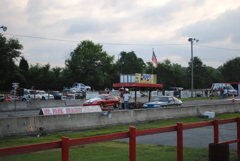

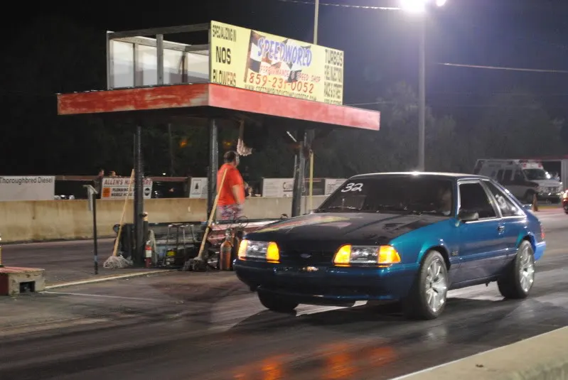

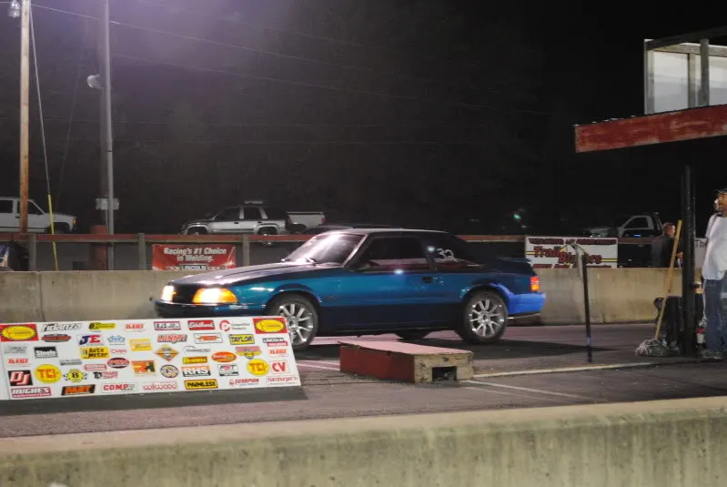

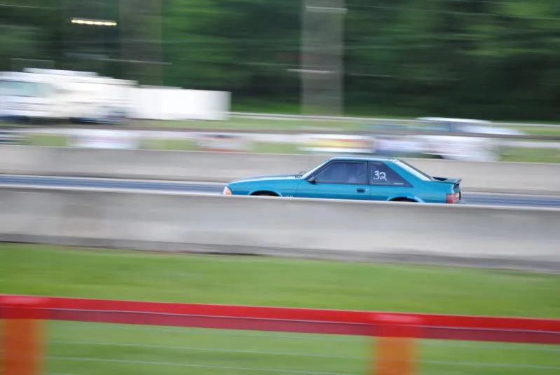

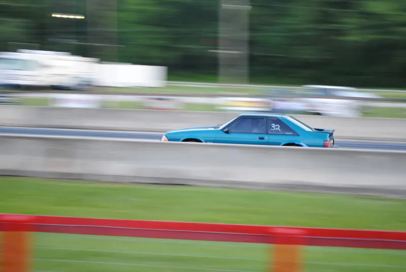

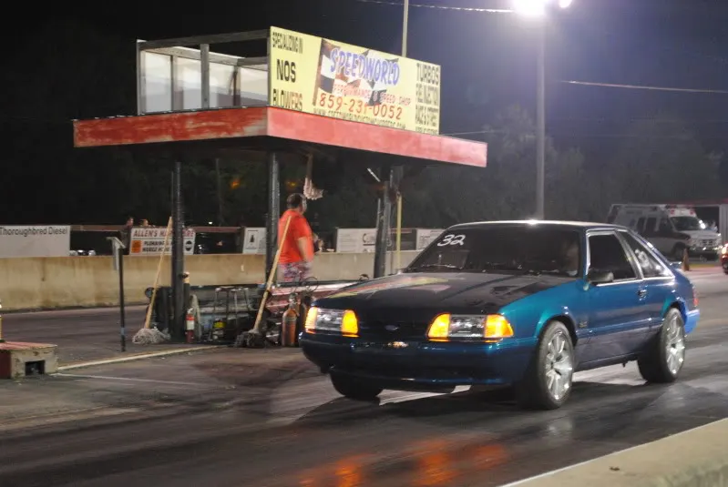

Here are some pics:

Those times and speeds are pretty normal times for a close to stock car. Sure looks good in the pics!

love the wheels man, car looks awesome!
Thanks a lot, they look even better in person than pics.
