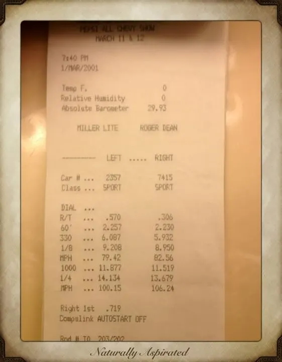

Here's what 290HP at the wheels looks like, 13.6 @ 106MPH on street tires. Had 4 runs all identical the same night.

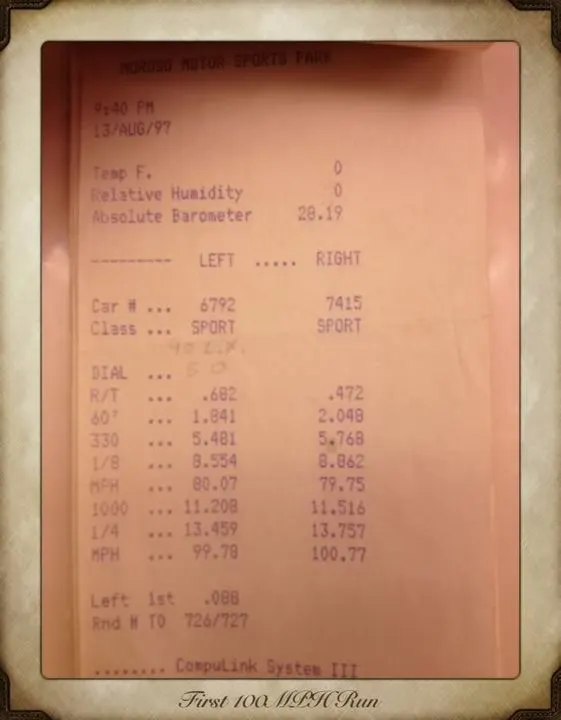

Here's what 241HP at the wheel looks like, 13.7 @ 100MPH on street tires. Had 3 runs all identical the same night.

Thanks for the time slips, now I feel like I have hope. Last year the car did best by winding out 3rd gear instead of going into 4th. This year with the new combo I had take it thru 4th to the end, so the power band is very different.

BTW, what was your combos for 241HP and 290HP?
290HP- Stock Block, GT40X Aluminum Heads (Box stock), Crower 15511 Cam Split duration, Scorpion 1.72 rockers (little more lift), Edlebrock RPM Intake, 70MM Throttle Body, Pro-M 77 Mass Air, MAC Long Tubes 1-5/8" w/ 2.5" Collector, MAC Prochamber 2.5", MAC Cat Back 2.5", Pulley's, 24lb Injectors, Kirban Fuel Pressure Reg, 255LPH Fuel Pump, 3:55 Gears, Full Steeda Suspension-Sub Frames, Upper / Lower Control Arms, Springs, etc.
241HP- Stock Block, Stock Heads, Stock Cam, Scorpion 1.72 Rockers, Edelbrock Performer Intake (not RPM), 70MM Throttle Body, Pro-M 77MM Mass Air, Pulleys, MAC 1-5/8" Equal Length Headers, Bassani 2.5" X-Pipe, MAC Cat Back 2.5", Stock Injectors, Kirban, 255LPH Fuel Pump, Same suspension, etc.
