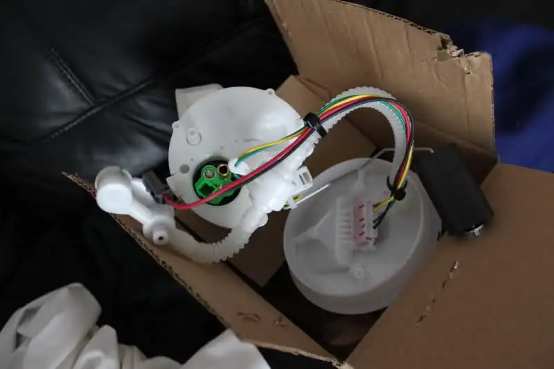

I got my SVTF pump..now drilling holes in the basket???
I got my whole assembly today. Paid $171 total and met up with the guy who got it from his work. Now all I have to do is drop the pump in my basket right? What about drilling the basket for more fuel? Yay or nay on that??

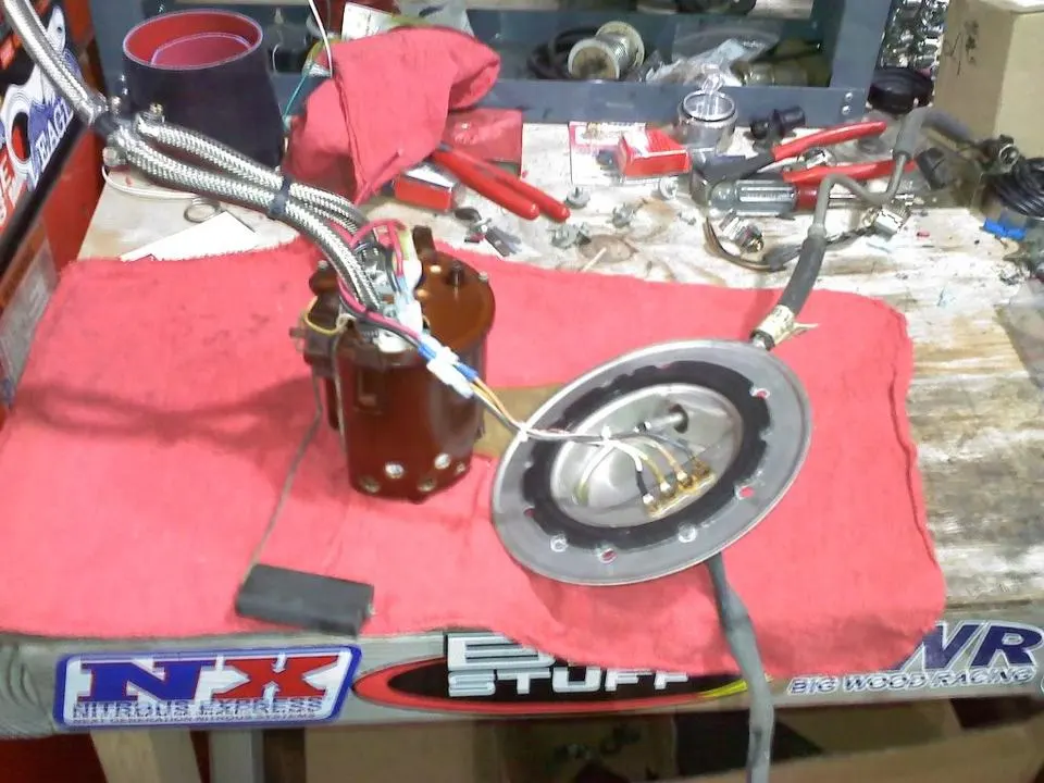

Only if you run a ford gt pump 310lph or dual pumps. (see pic below)
BTW that's dual ford gt pumps and they run just fine with a few holes in the basket. And if I had them at 100% its = to 163 gallons per hour or 5.7 minutes to drain 15.5 gallons of gas out of the tank lol.
