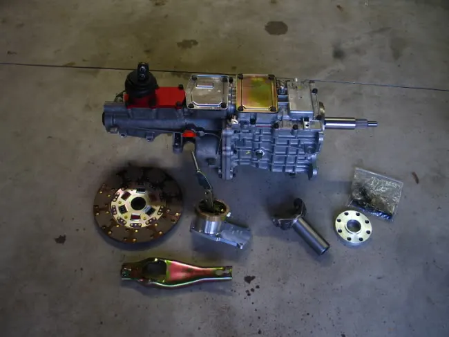

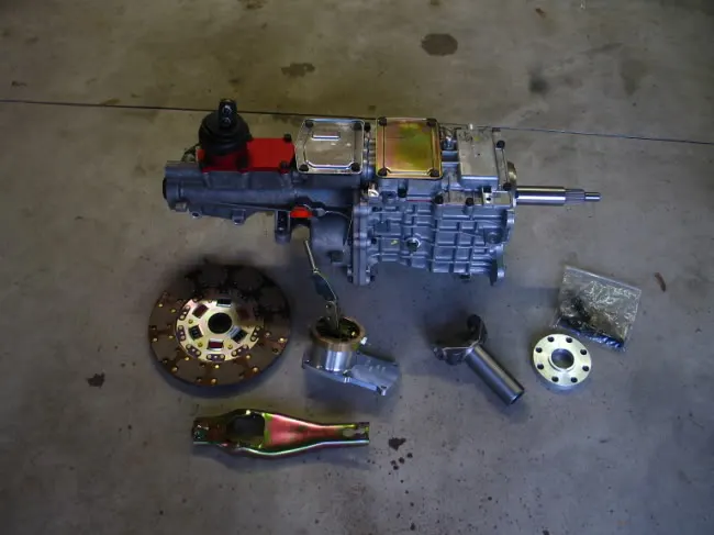

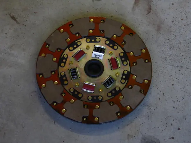

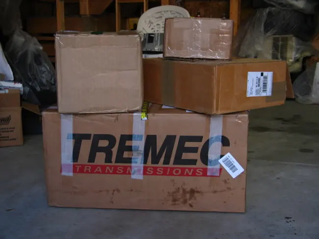

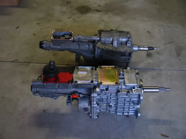

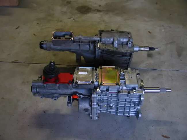

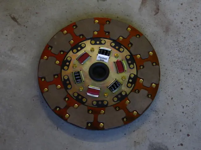

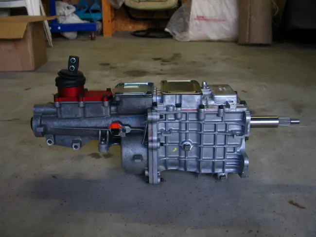

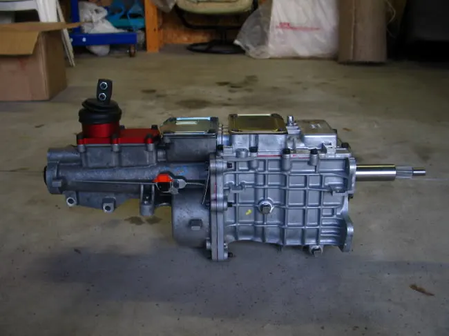

This morning brown truck pull up on street and guy start bringing boxex, 4 boxes ,neighbor cross street was like "WTF this guyis going"
One of boxex was heavy , 115lbs :D TKO500
Here is a few pics

eades5.0 said:
Awesome!
Why the 500 over the 600?
The 500 has a 3.27 1st. gear and the 600 has a 2.95 1st. gear, you would lose on the launch and 60' time since our cars are so heavy. Other than that the tranny's are exactly the same.

But T5 will never hold big TQ like TKO ,even G-force
