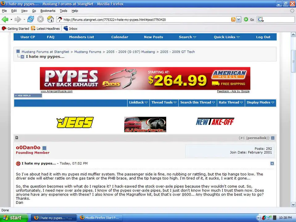

How ironic that as i was reading this thread the Pypes cat back systems was in the banner ad at the top of the. hahahah
