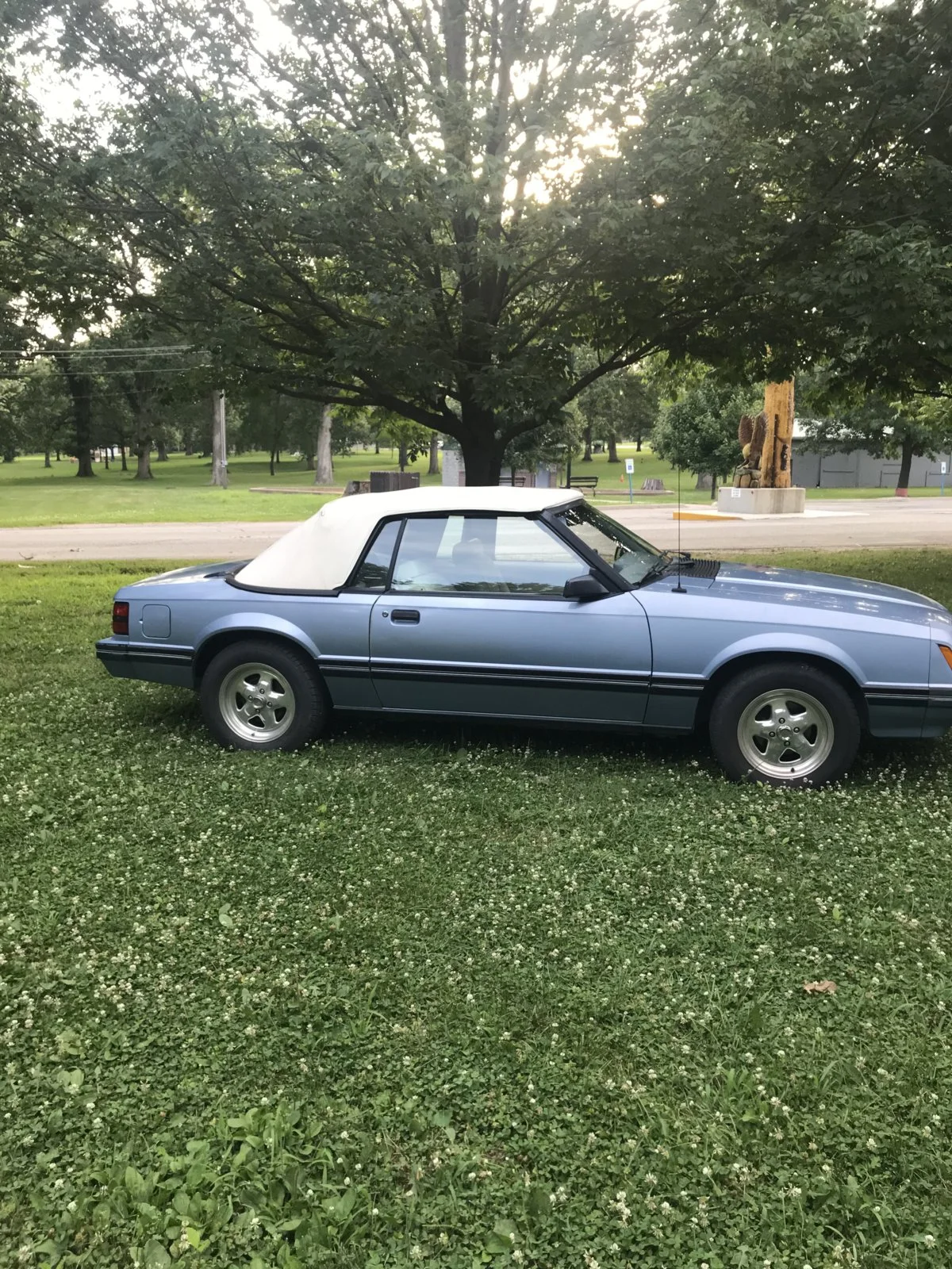

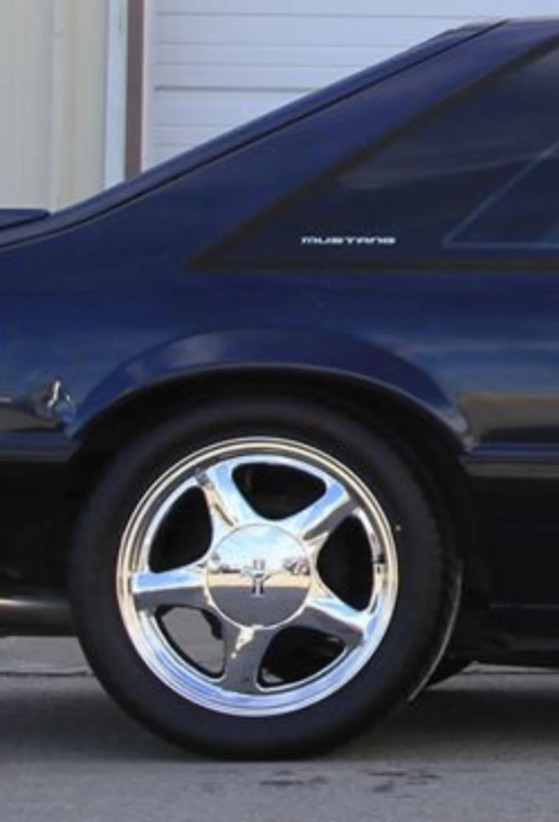

I would really like some suggestions, and pictures if possible. With wheel, and tire sizes.
Here is what I’m working with.

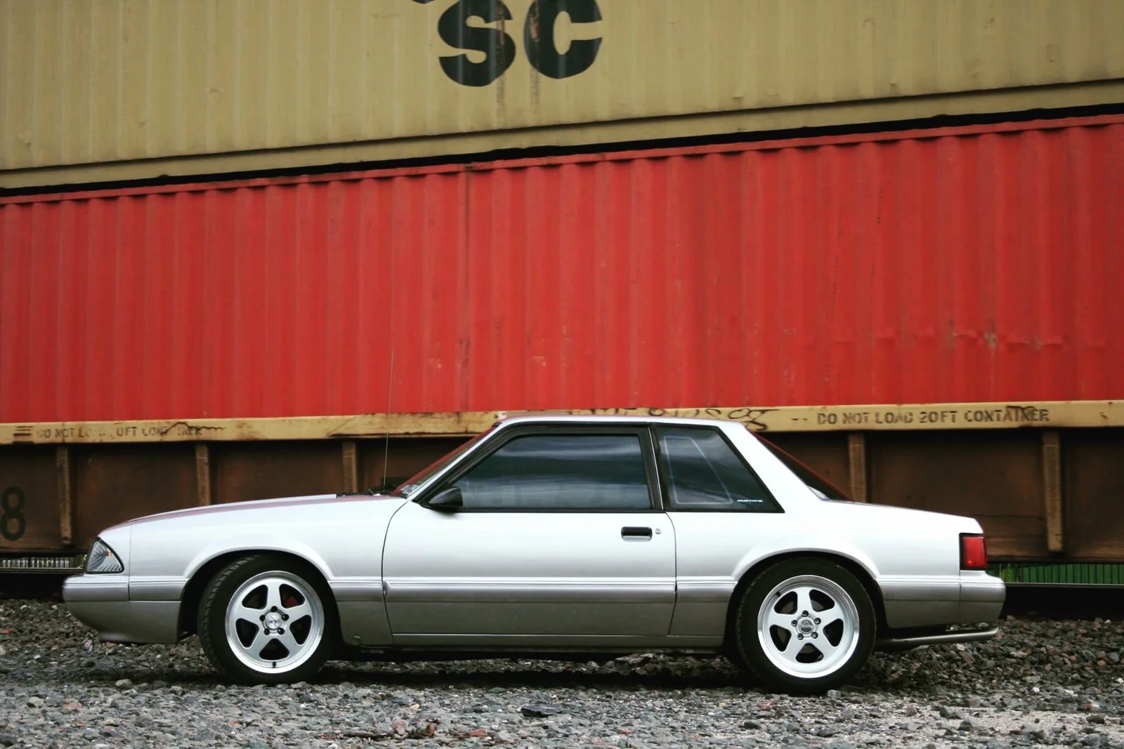

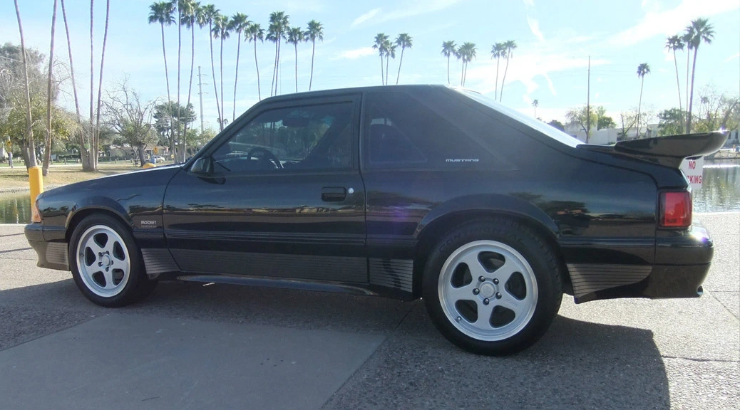

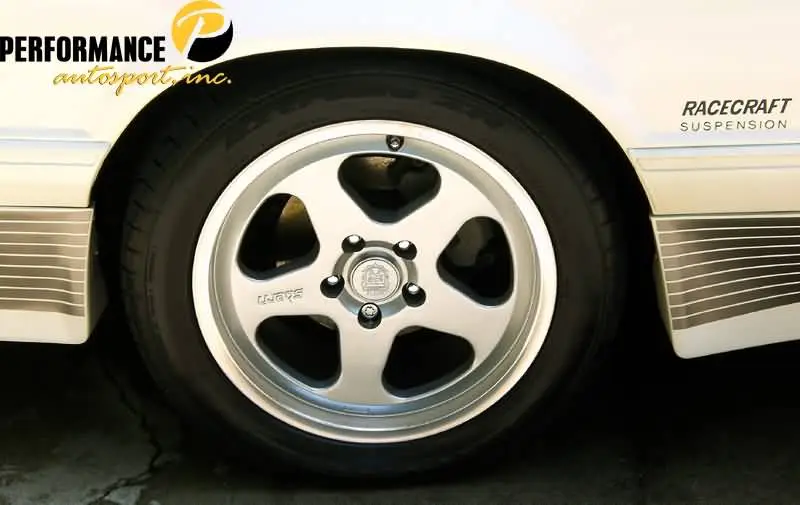

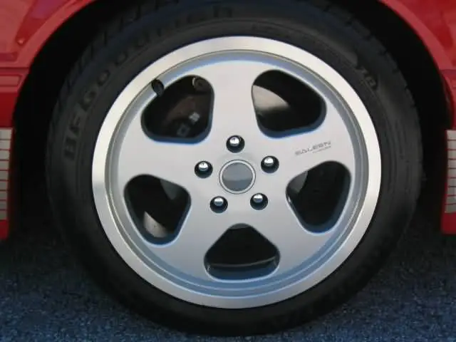

Sve Saleen wheels
17x8 17x9 :drool:
And yes.. they come in 4-lug, these just popped up first on Google lol

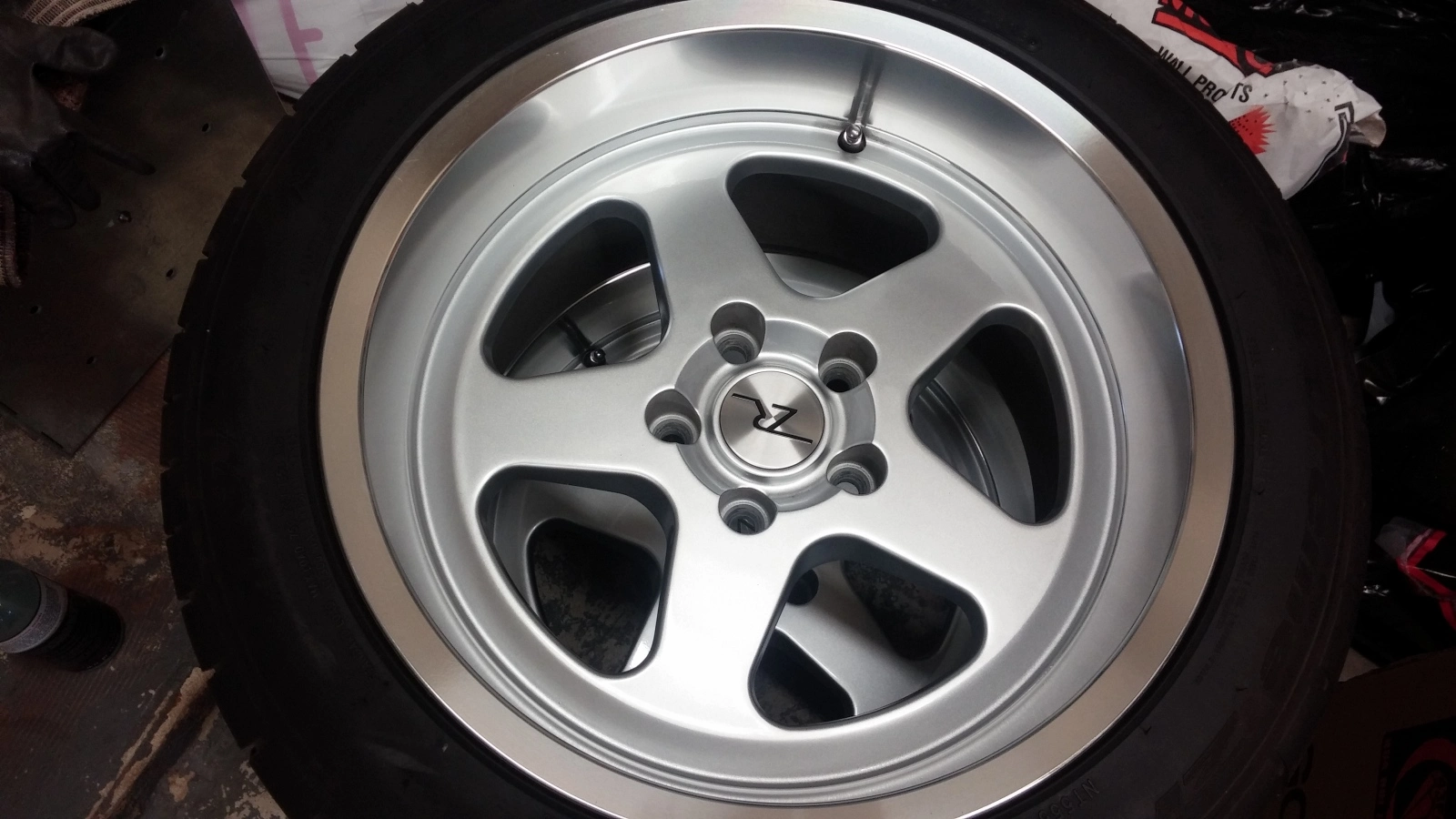

These are the ones I have on mine now, why are they called Saleen wheels, did the saleen come with a similar style? People compliment mine quite often but I actually think I want more of a weld prostar look eventually after a 5 lug swap.
Reactions: LAFF
They are a replica of the 1 piece Stern wheels that came on some fox saleens.
I remember there was always demand for them and then LMR actually released a set and they have become quite popular

So let's assume 5 lug (which is the smart thing to do).
I'd say a wheel no smaller than 17x8, no larger than 18x9.
Michelin all season tires
I'm doubting you want any headaches, so i'd say limit the width to 245. Can you go wider? Yes, but when you pass that size fitment gets tight, some people are willing to do what it takes, some aren't.
The wheels and tires are going to be easy.
It's the brakes and 5 lug you need a plan for.
Quick and cheap is lincoln rotors up front, ranger axles and drums out back. But there may be center cap issues with the front wheels.

I’ll keep this in mind. Thanks
