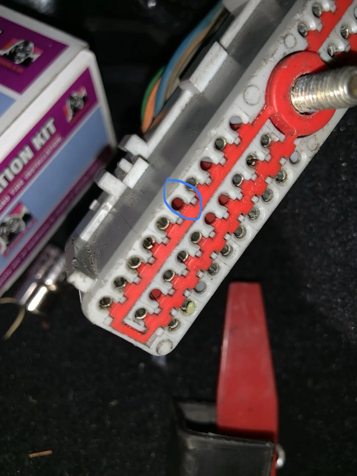

Jrichker: Thanks for the diagram. After taking a look, I’m definitely missing a wire on the harness side for pin 46. I checked the back of the harness just to be sure and it’s not there. I think I saw in one of your checklists that wire 46 grounds a lot of sensors on the engine. Here’s a pic of the connector. Thoughts?
629457
The pin 46 thing is odd. It can't be just missing as it would take a to of work to fully remove that wire. Could it have just pulled out of the connector?
Was the car originally a manual? If so the whole A9P thing is confusing as to why it would have a auto computer in it. Also the O2 sensor harness is wired differently for a auto vs manual computer. Can you verify which way the the harness is wired?

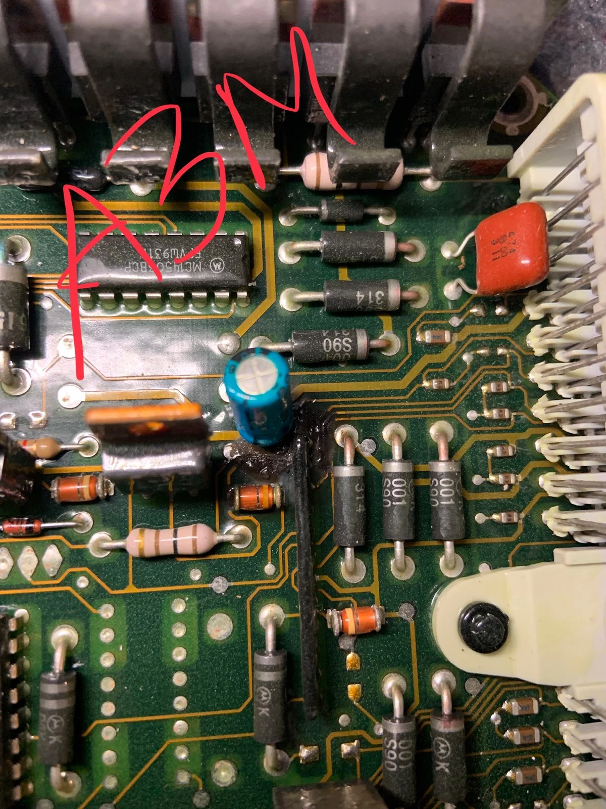

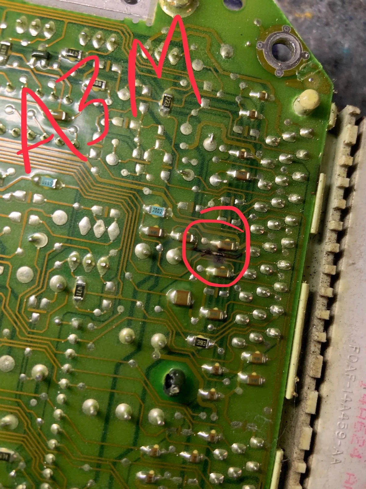

Dan: I think Saleen just addressed our error. I didn't notice the red marking on the harness in the picture that jrichker posted as I was following the "wire/computer side"description. We should check to see if there is 12v going into 46, correct? If there is 12v, then we have a grounding issue? Also, the car came with a A3M when I bought it (the car is 5/92 dated on the VIN Sticker). Factory 5 speed V8 car. The capacitor was blown and burned the board so I bought a A9P as a replacement.
The O2 harness has the loop wire like this example("*" = wire, "J" = jumper wire) :
|***J|
|**J |
We are going to verify this layout to be sure. I also put pictures of the blown A3M below

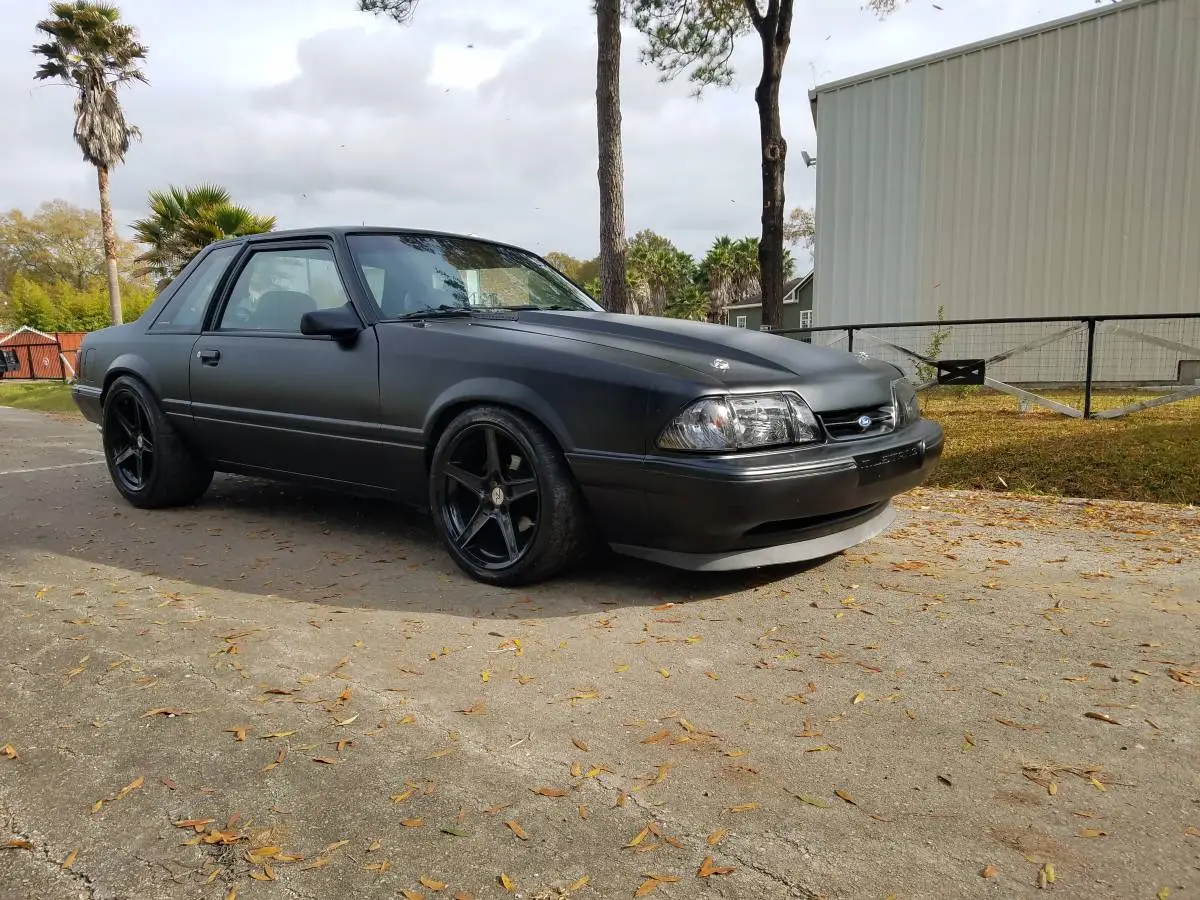

Hope you guys had a great father's day! Dad really loves the car! Caught him completely off guard lol
|***J|
|**J |

THe one thing I notice is that your using a 9AP which is for an automatic being that the car is a factor manual this may be a problem with the 02 sensor and could cause the capacity to blow. I would use a A9L which is correct for a manual. Since you went through all the steps which looks good this is the only thing I see that could be a problem. I hope this helps and I'm glad your dad likes his Foxbody coupe!
