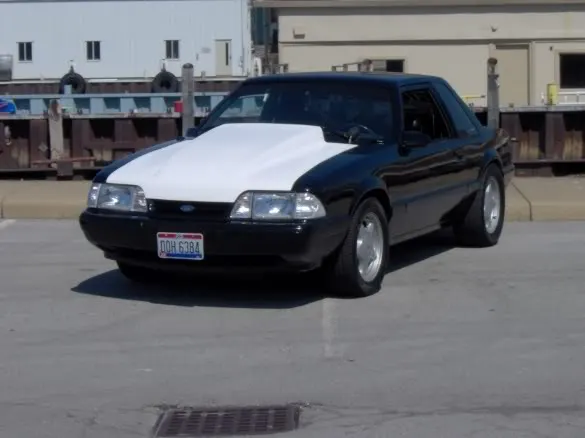

i need help with tire sizes

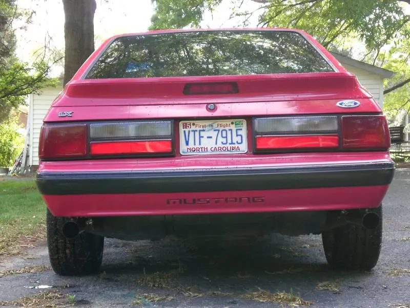

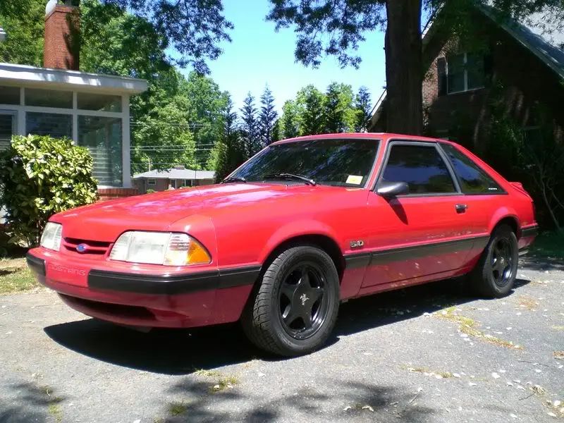

Not much wider but these are 235/55/16

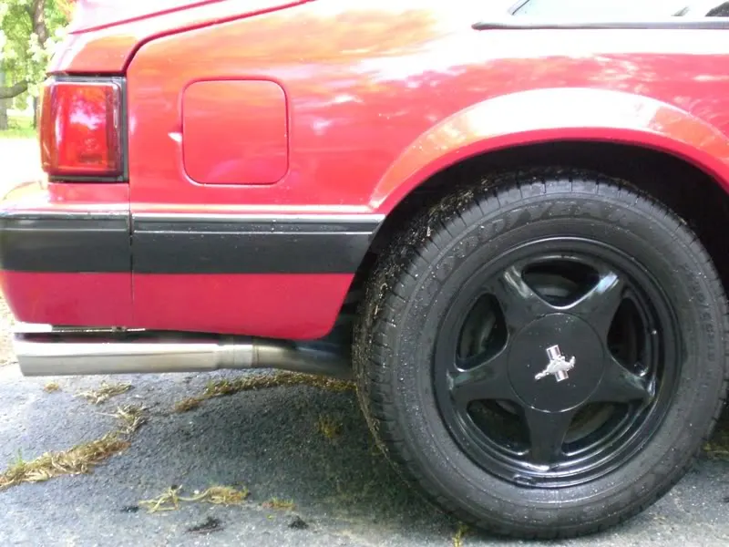

255's are the widest you can go on stock ponies. That is with a 40 or 45 tire. You could go 265 if you had a 55 or 60 series tire. But those are taller and will look stupid. I had 245 Goodyear GSC's on a pony wheel and it fit great on the wheel and looked great on the car!
yeah, i was always told 245/50/16 for the ponys. I need new tires too and was going with bfg kdw in that size. I think that would work for ya :shrug:
