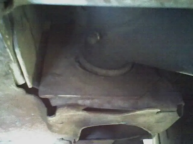

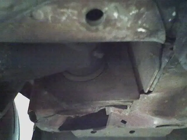

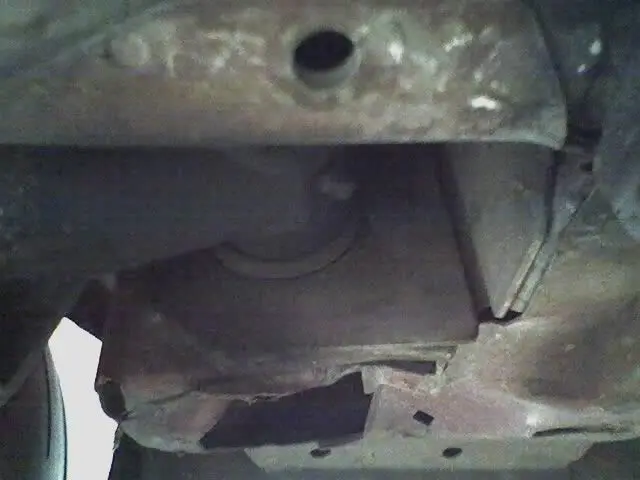

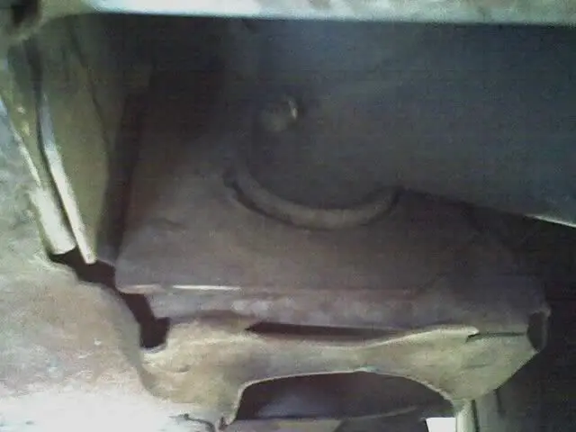

Well my car car puts out over 630 ft/lbs of torque.. which is the nice part...
the bad part is this...
the other side is the same, both sides are ripping out...
I went to the local track this last Wedsnesday and upon launching, I noticed a noise I have never heard before... Made a loud popping noise. I was using drag radials for the first time and being that I have a SPEC stage3+ clutch, I am putting that torque on the tires, so Im in trouble now.
My lower control arm braces (or torque boxes) are being torn off, how do I fix that without having to back-half the car and making a 4-link set up? Any kind of bolt/weld on kits out there that I can buy and be durable enough to withstand some drag racing once in a while?
Sorry for the picture quality, they are only cell phone pictures, but trust me, they look bad!

They do make weld in tourqe box supports, do a search and you should find a few differnt brands. THe only way to fly with these cars and DR's
EDIT:
http://www.uprproducts.com/shopping/shopdisplayproducts.asp?id=67&cat=Torque+Box+Kits
I have seen good things from Wild rides Battle Boxes
