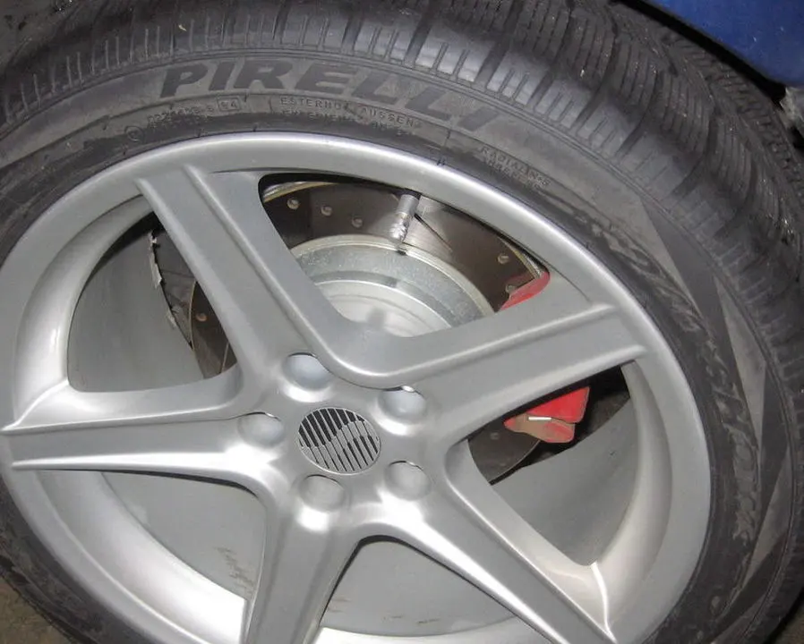

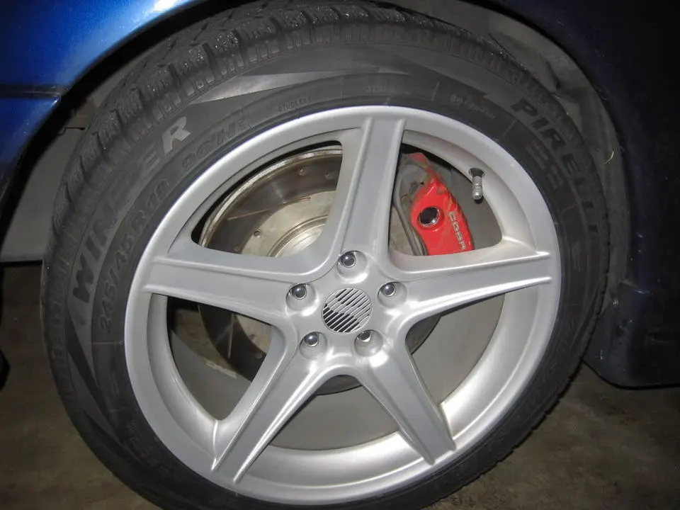

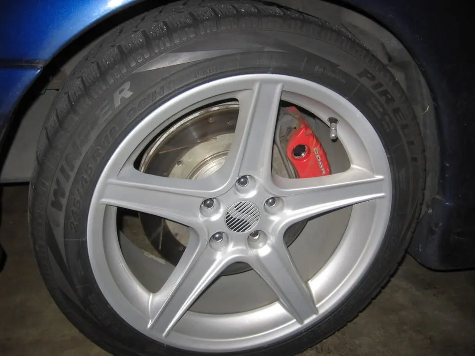

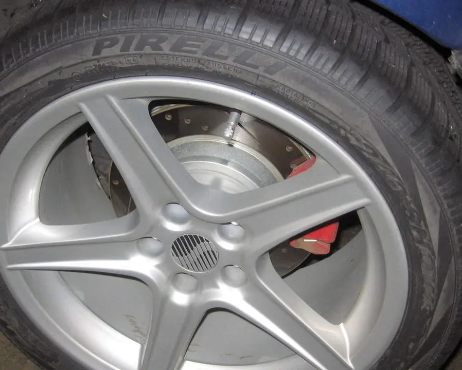

I did the Cobra upgrade front and rear. Stainless lines zinc cross drilled and slotted rotors. Here are some pics........

That's what I did. Here's a couple quick pics - note that I had just washed the car, and brakes immediately turn to rust when wet...! :nonono: :shrug: They do, however, fill the wheel out very well...:nice:
Thanks for the pics, looks great. I was going to get the black ones but I like the red because it stands out. I was thinking of getting the front cobra brake kit and just paint the rear calipers red for the time being.
