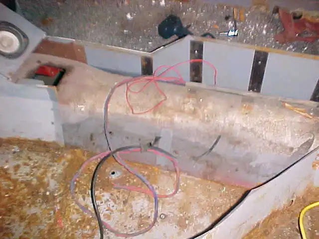

Lets see, the console is under the fabricated floor. It was made in 2 pieces, the floor and then the top section that is attached to every part of the inside of the car: kick panels(fab), rear seat area, console, trunk divider, etc. This guy was crazy....And like said earlier, it is a good thing that he didn't have a fetish with his welding gun, instead he went for a rivet. He probably didn't know how to weld. Thank god. Yeah the car does mean alot to me, had one 2 years ago and had to sell it because of college but know I want to do a ground up resto. thinking 2-3 years on this one. I have three auto shop buddies to help me. I just like to get as much feed back from people as I can. That is why forums are great cuz you usually have someone that has done something simuliar to what you are doing. And really just people to push you along.

Well, I don't know how bad it is, it is going to require a lot of work though. The first pic looks like some home made bolt in subframe connectors. At least the guy had an inking that his pop riveted floor (and screwed together floor, see first pic) wouldn't hold up. How about removing all the pop rivets and let us see what is left? Are we talking coupe? fastback? 'vert? Big problem is finding a transmission tunnel as I don't believe they make thos as repo parts. Another thing, do you want to restore or restomod? Road Race or Drag Race? How about a firewall back 2x3 tube chassis with roll cage and a Pro Street look? If you're restoring, listen to SD and get another car (unless you're like that couple year old Super Bowl commercial where the guy has cash comming out the wazoo...) But if the rest of the body is in okay condition, customize away and make lemonade from your lemon.

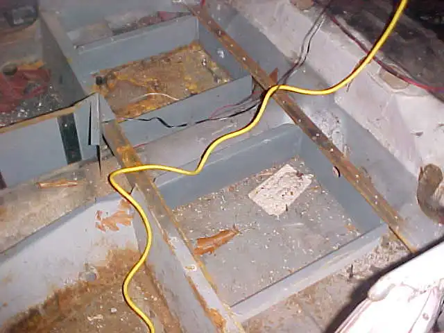

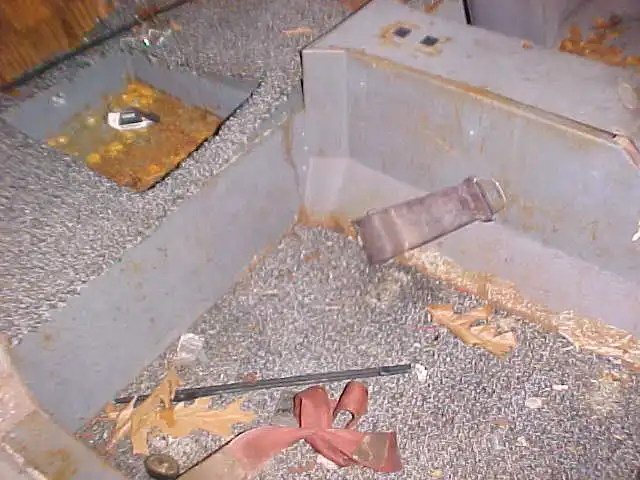

Ok, lets see if I can explain this. There is a transmission tunel if you look at the pic shown, he just covered the hole thing. Ok. He made a floor over the origional floor. The rockers are great condition. He didn't cut much of the origional floor out so it wouldn't be bad welding a new one in. I had a buddy look at the subconnecters and he said they were fine. They where for racing, the previous owner did drag. He put huge leaf springs in the back. He also covered the rear were the seats go, giving it a flat surface. I was worried to but the structure is sound. And it is not as bad under his work as I thought but I still am expecting the worse. Trunk and everything else looks ok right now but I will have to see after I finish stripping it down.
http://forums.stangnet.com/attachment.php?attachmentid=18515&stc=1
http://forums.stangnet.com/attachment.php?attachmentid=18516&stc=1
fabricated floor still on top of origional.

Okay, it's a '67-'68 coupe or a fastback (I'm guessing coupe). Don't see any vestiges of a roll bar or cage. You've never mentioned what you plan to do with it. There's been some threads on here of a Shelby like rear seat delete, you've got a good start on one there, if it's easily removed, and you don't want it, someone in that thread may be interested.
