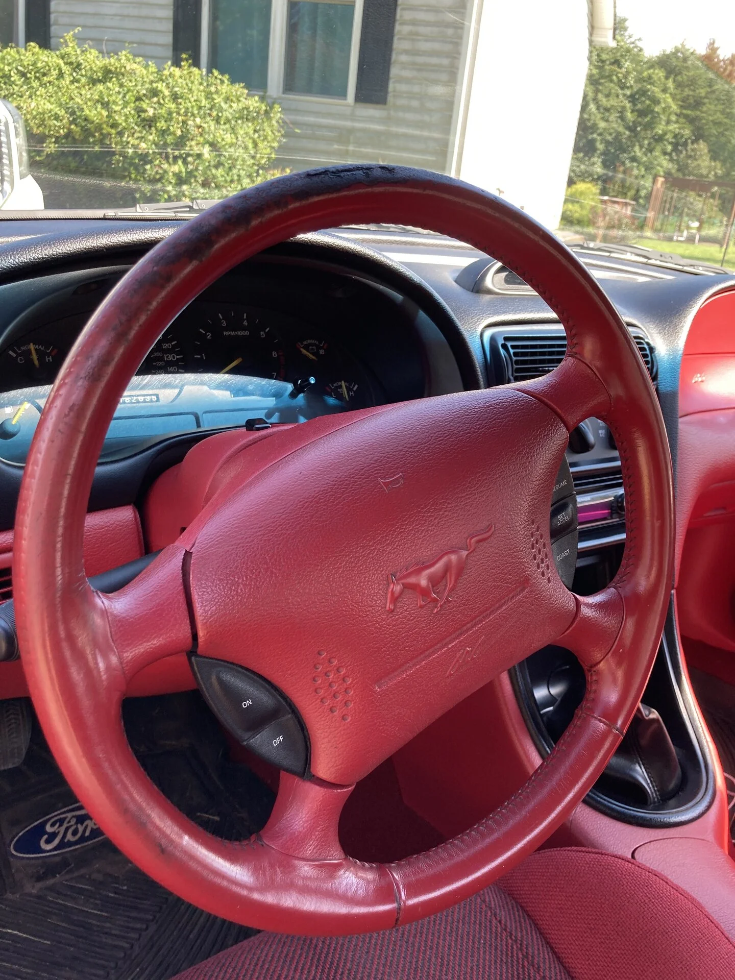

Heres how the steering wheel looks, not as bad as i thought but not as good as id want.

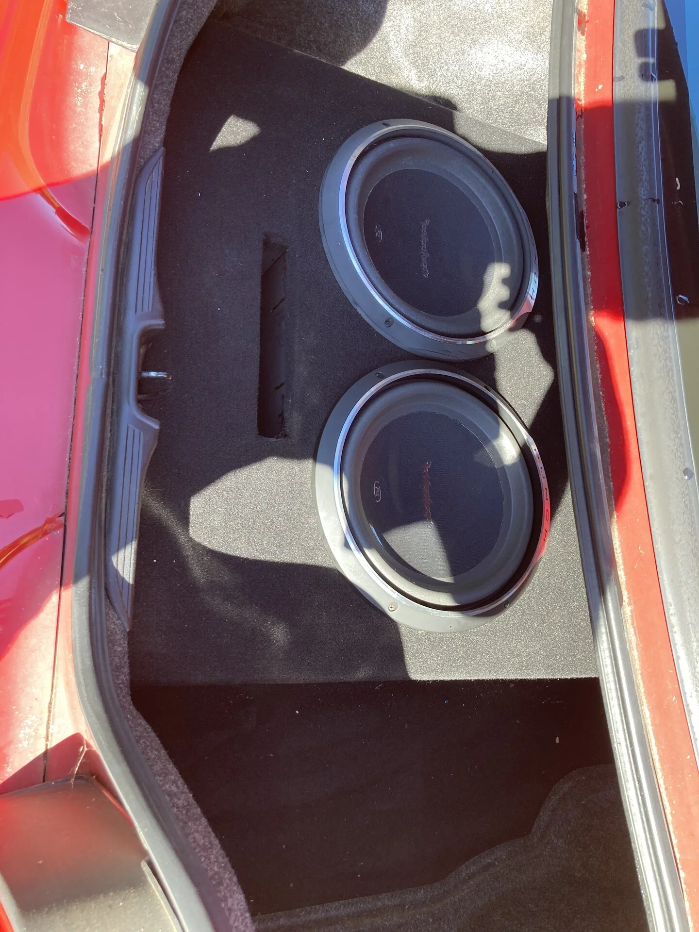

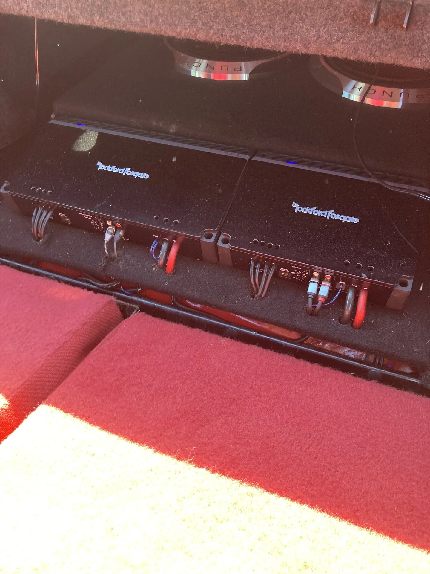

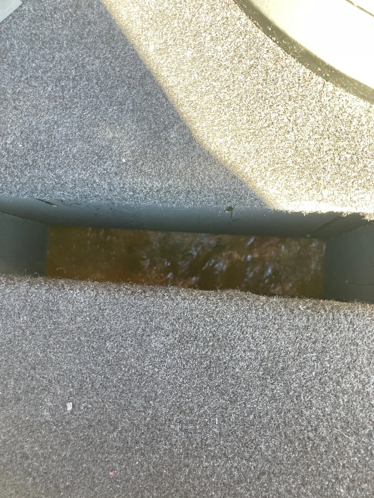

And a couple pics of the custom spare tire sub box, im not huge into it but clearly alot of work was done to make it fit and work. I tested it and can confirm even though it was probably done 12-14 years ago or more from my local audio shop, its WAY too loud! Looks like they fiberglassed it and all.. original owner said it costed 3k$ at the time.. anyway this is it nothin fancy but:

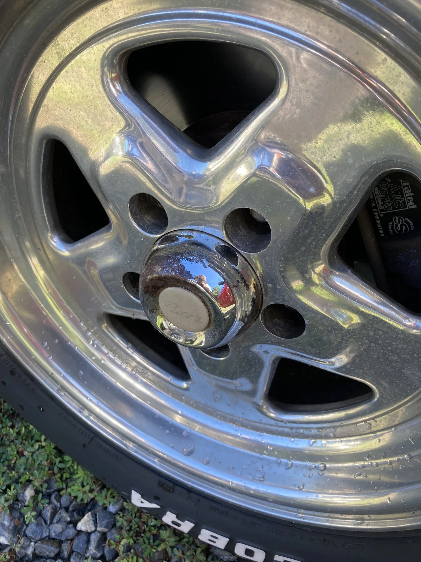

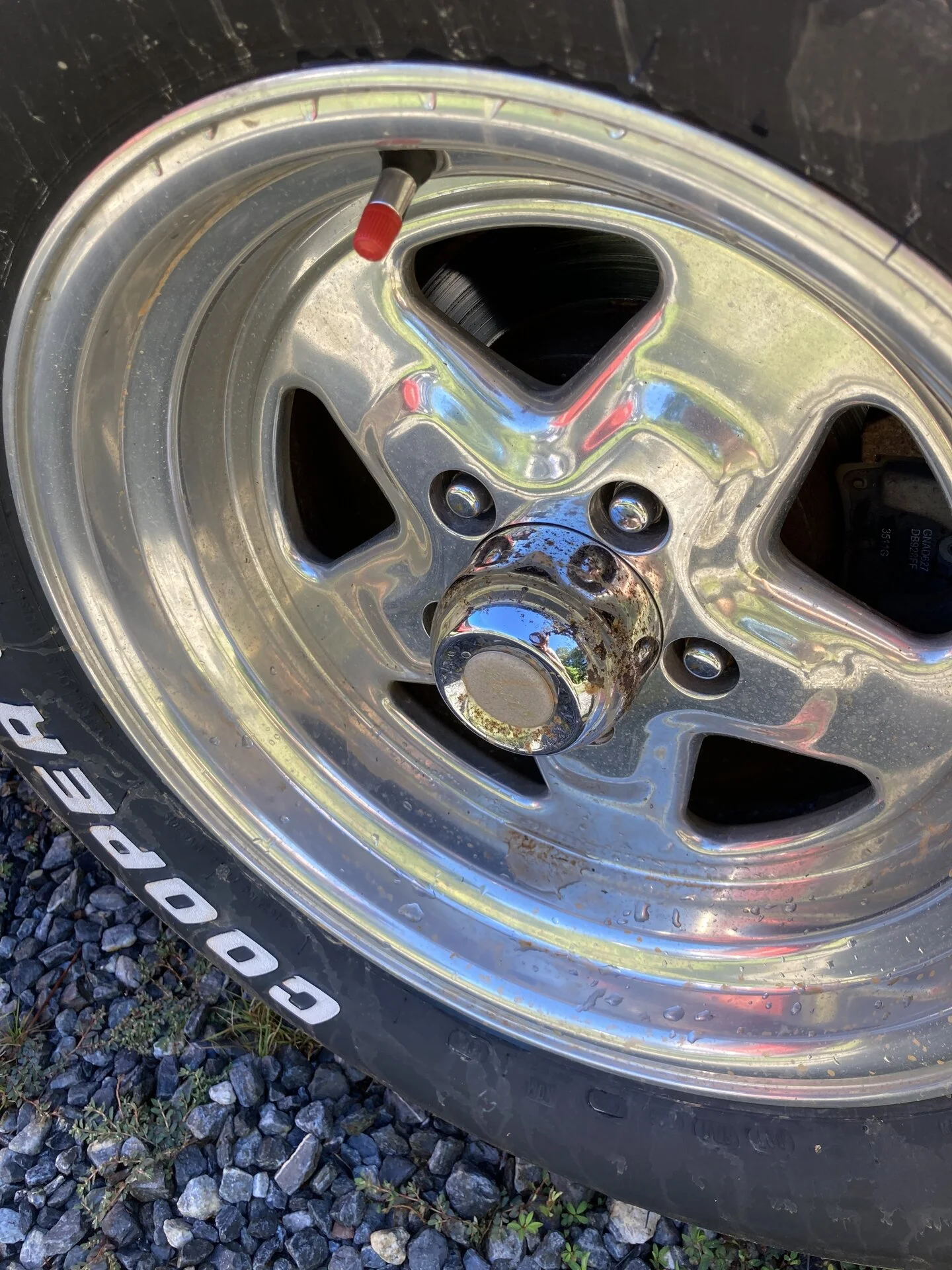

Hey guys i want to get to work on these rims when i get some time and am having a hard time finding the center-caps that match.. if anyone could help me out finding them online to order that would be awesome! Heres a pic of the front and back, they are different it. The back is longer (sticks out more)

Does anyone know if these rims are clear-coated or how to know for sure? I started on one with some mothers mag aluminum polish and it turns black so im assuming its bare aluminum, but having no luck polishing
Go to home depot in the cleaning area and they have a bristle brush that goes on a drill. Use lots of that stuff aand work it like crazy. Wipe them good and they should look new. Iv done it on a few sets that looked totally pitted and they look new. If the black stuff comes off then they will clean up

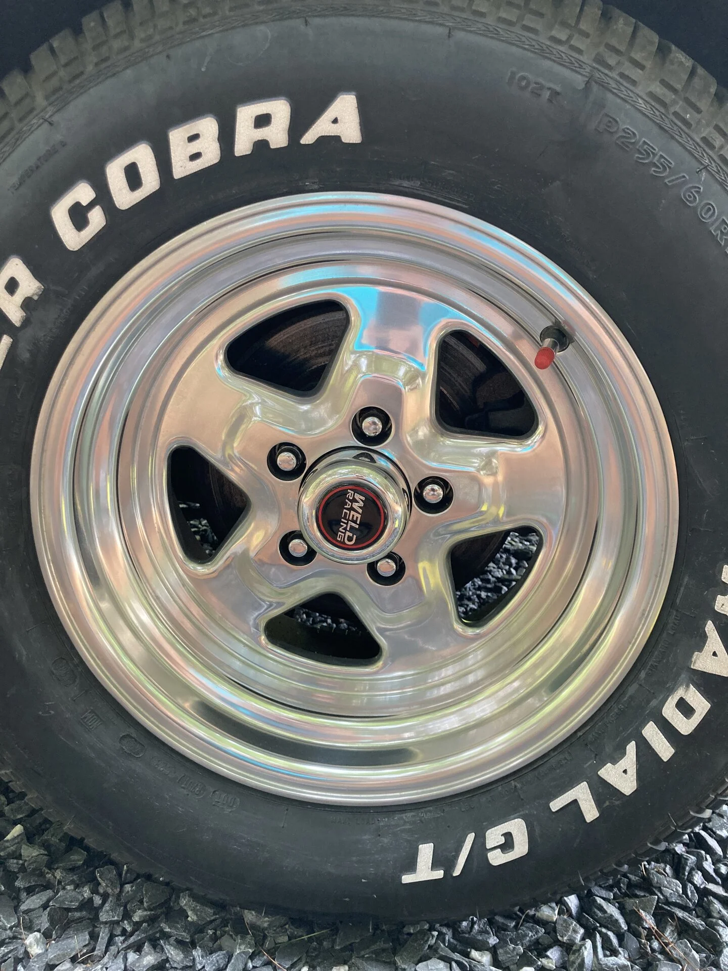

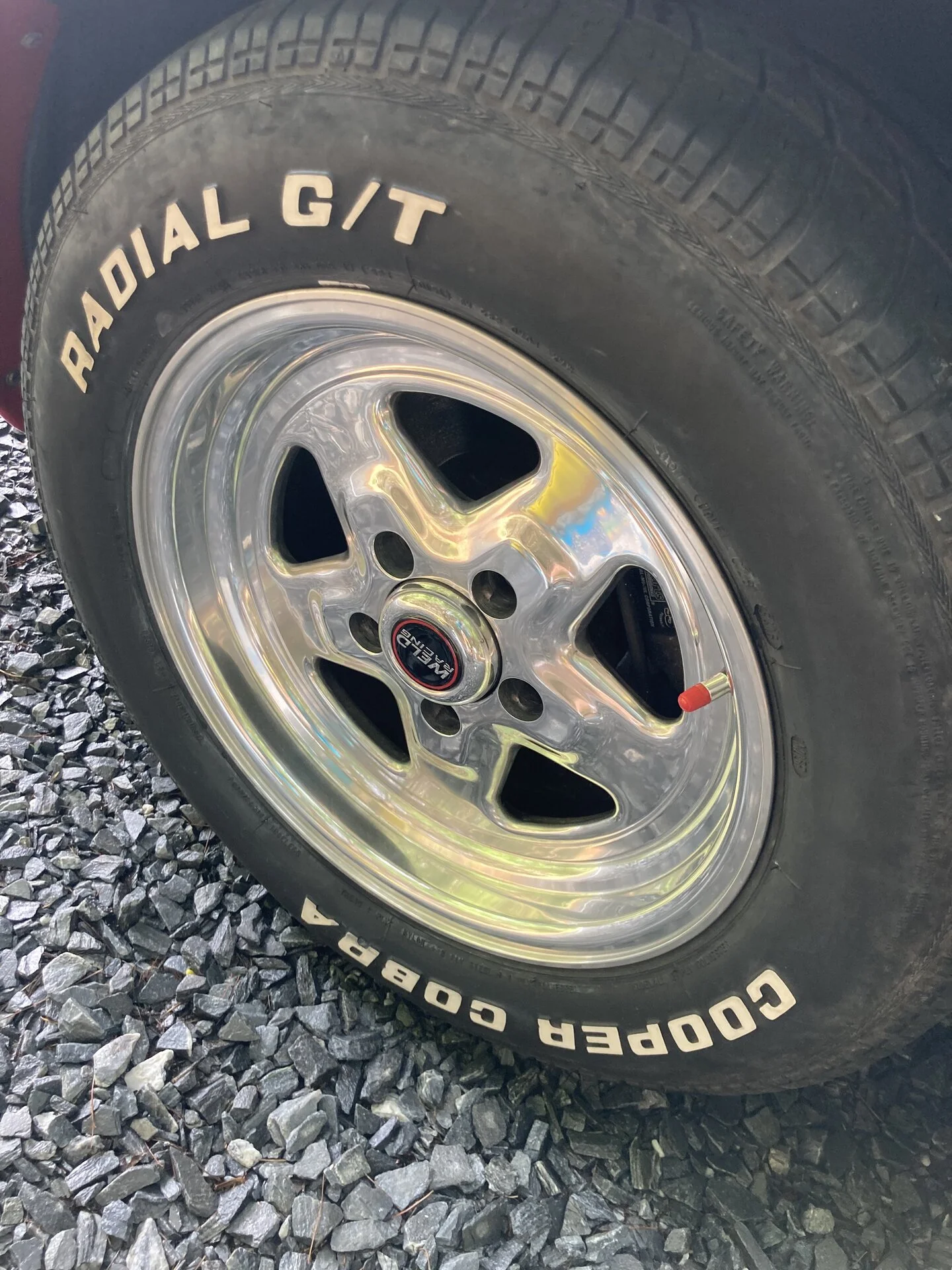

Update: Finally got some time to sit there and experiment and figure out what actually would work. I tried a buffer on a grinder with rouge first and it did absolutely nothing which i found to be quite crazy, then i tried that #0000 steel wool again but this time used polish on the steel wool and polished that way, which i didnt think to try before and let me tell you it works wonders! Its very quick and easy too, im pretty amazed. Although i did have more pitting than what appeared to be, so i took a long time to sand it with 2000grit and then polished with the wool and then finished by polishing with the foam polisher cone on my impact drill. They are not 100% perfect since some of the pits are in weird spots hard to sand, and i should have probably started at a courser grit but i dont have unlimited time, and this way gave me results im happy with, and only took about 3-4 hours. Anyways here they are with my new center caps and all!
