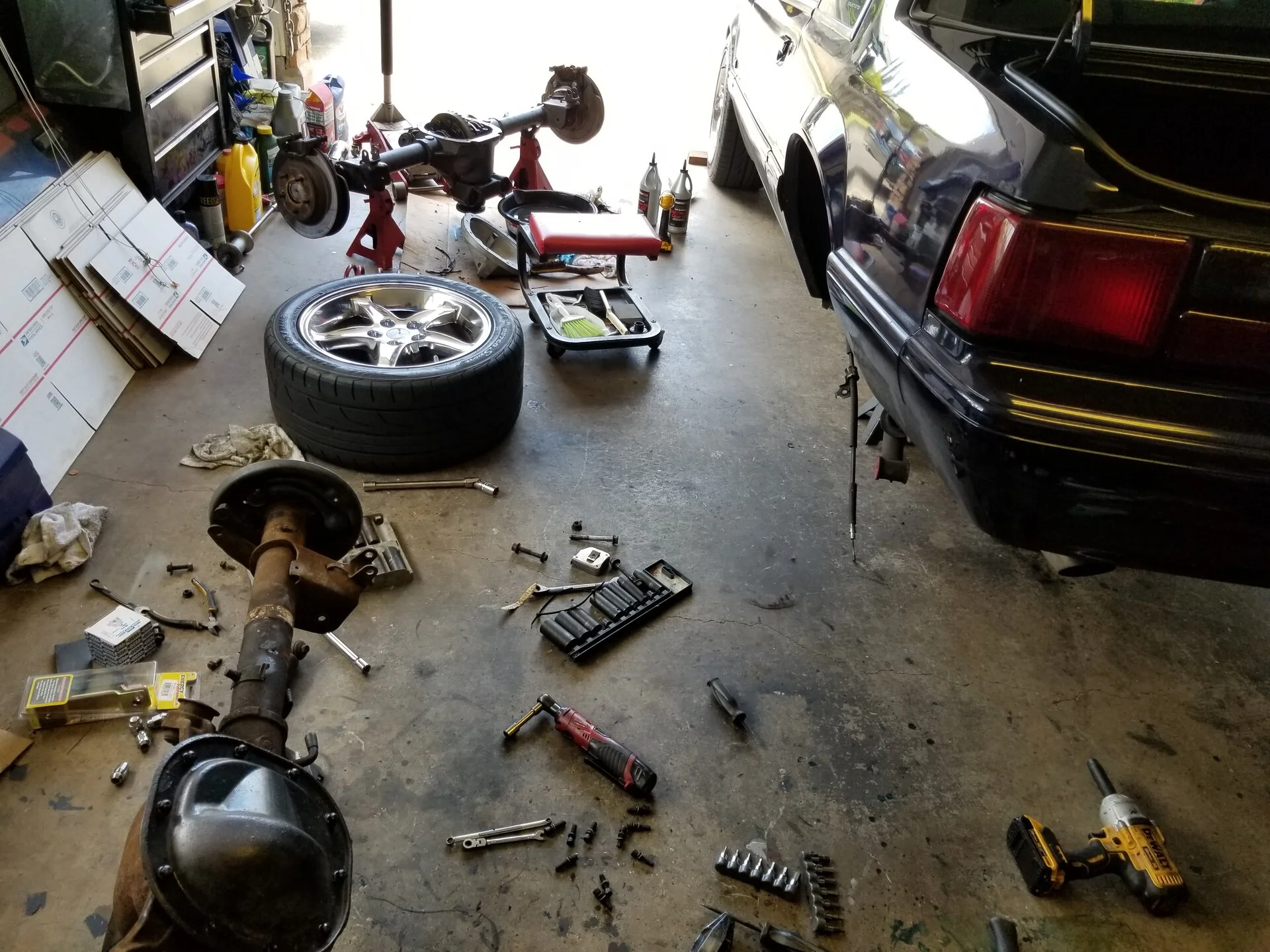

Spent my day doing this. What fun!
I picked up an 8.8 from a friend. It has 3:08 gears. He also gave me a set of 3:27s. I installed the 8.8 in the car with the 3:08 gears to give it a try. So far I kinda like it. Cruises smooth and I can roll into boost without the back end skating all over the place.
