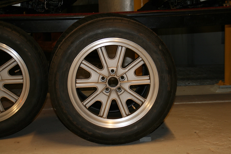

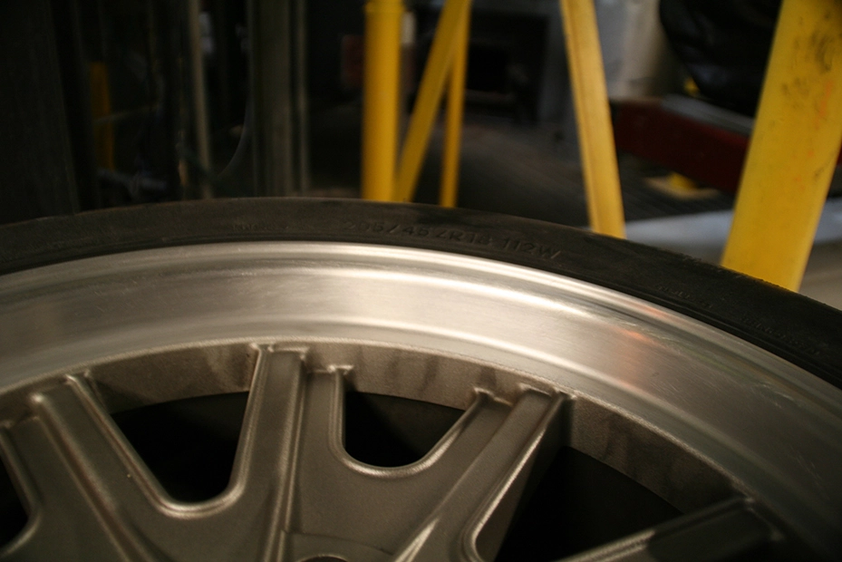

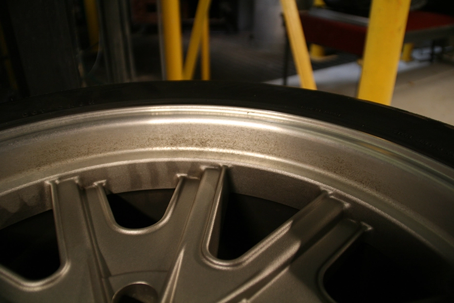

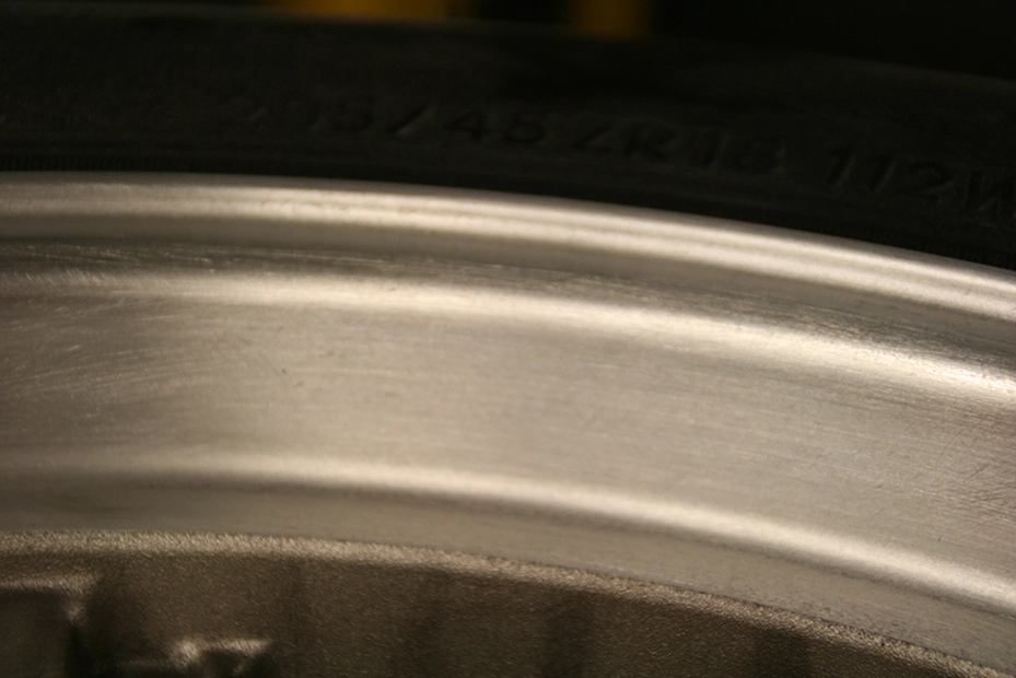

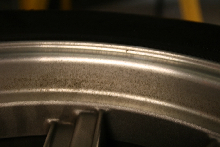

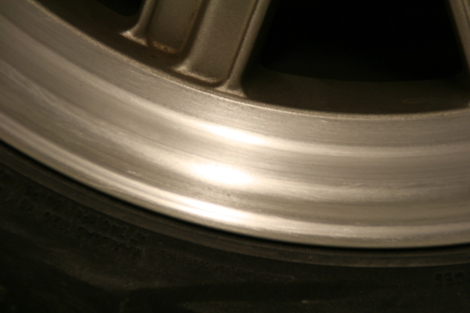

I had the same problem last winter! The winter chemicals ate up the polished lip on my Cobras:mad: I tried several different polishes, compounds, really fine steel wool and none of it worked well enough for me. I ended up sanding the lips down by hand with fine emory cloth and coating the lip with several coats of metal polish. That took way too many hours:nonono: I haven't had them out in the weather yet since, so I don't know how well they are protected. Next step will be powder coating the entire wheel if not new wheels.
Before
I know there is brake dust/dirt on the inside part of the wheel, but the lip has been wiped down.
After
