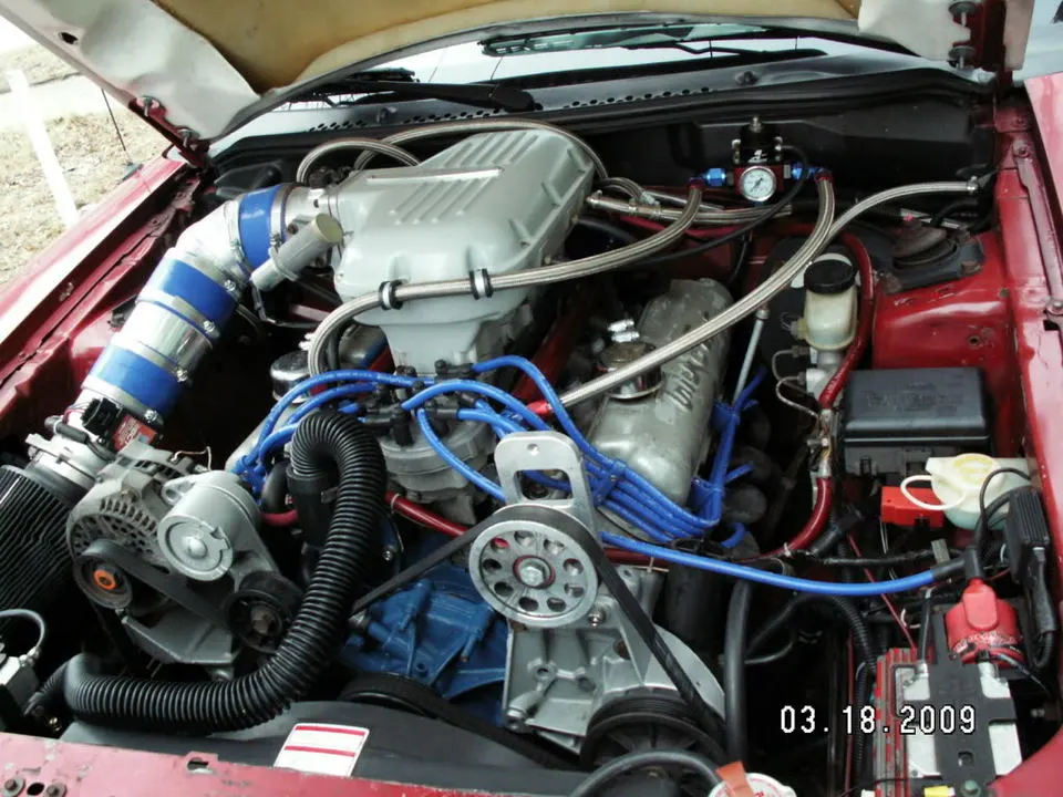

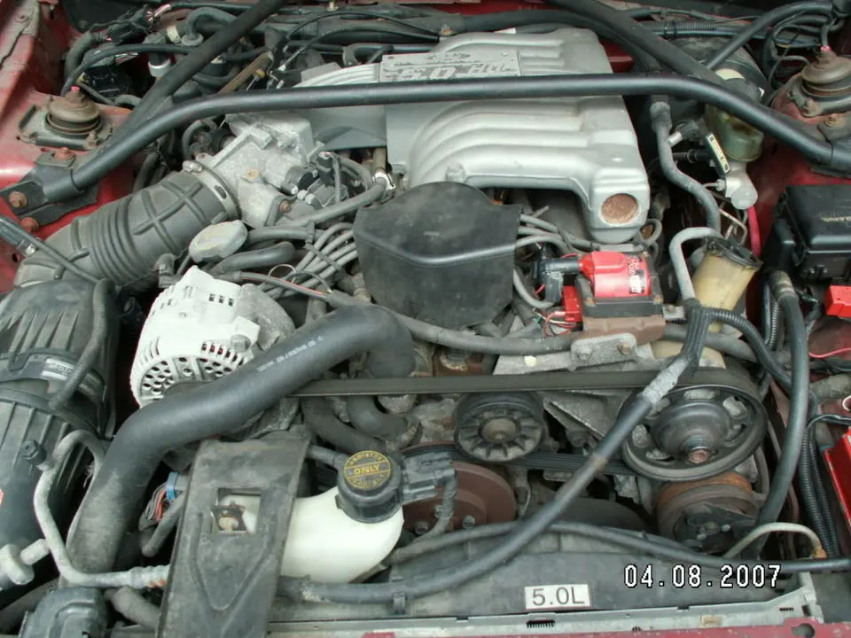

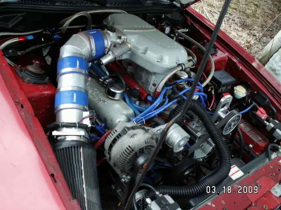

Heres Pics of Fox brackets on my 351 block (wider)...Now pay attention to the clearance on the side of the motor. And ill toss a Stock motor pic in for fun.

The brackets on the SN are set wide in order to clear the hood, kind of. A 95/95 engine is approximately 3" shorter than previous 5.0 Mustang engines. In order to get the engine 3" shorter, they had to tuck the AC compressor under the engine slightly, which is why it was moved to the bottom.

Actually 1st thing i noticed when swapping to FOX brackets is that It really didn't clear the electric fan. With that said....Look at how high the 94/95 bracket sits Almost on top of the valve cover.
Like i said...when i did my measurements when buying a hood FOX brackets cleared my stock hood....EVEN on a 351.
The issue is that ford shortened the engine compartment. YES the Radiator support is closer to the firewall in a 94/95 Than it it the FOX. If you look the Alternator actually sits higher than the oil fill cap on the stock motor. My FOX brackets almost sit the alternator lower than my breather. Thats why they also changed the water pump to be shorter.
The compartment is so much shorter that i couldn't put a Fan and clutch on if i wanted to. I had to clearance the Radiator so its 1/2 way under the support just so i could get a Mark viii electric fan on there.
