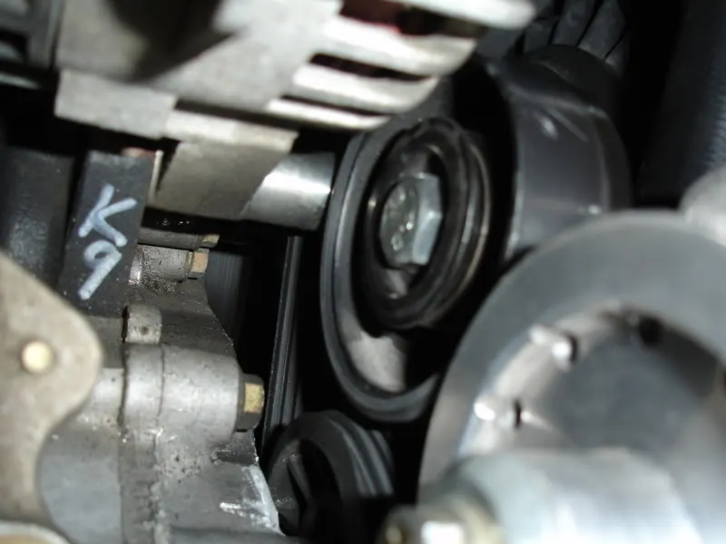

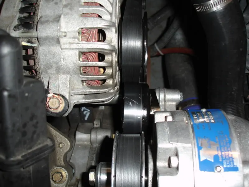

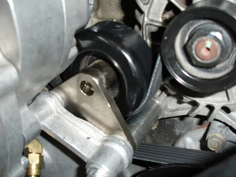

UPDATE:
To make a long story short my tensioner seems to be maxed out and something is squealing pretty loud under the hood. I think its the idler pulley between the blower and the alternator. I called vortech and the said I should be using a 107.5 belt instead of a 107.3. So tomorrow I am thinking about picking up a new belt, tensioner, and idler pulley to help the problem.
Pics of what I found...
Anyone?
