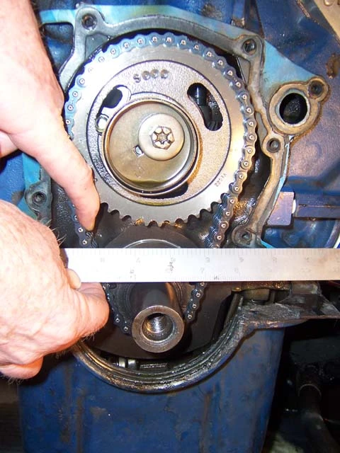

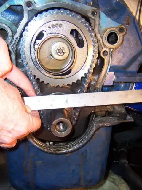

Quick update, finally got around to tearing into the engine somewhat. Timing chain looks pretty good... not sure how much play there's supposed to be, but there isn't a whole lot (looking at the engine from the front of the car, the passenger side of the chain has a little play (maybe an inch back and forth) but nothing major... i think.

1) An inch of play is way too much (even assuming you mean +/- 1/2" for a total travel of 1"). Although it may be tight on the pulling side at the moment, the slack will cause the cam to advance ahead of the crank then stop, then when the crank catches up again it will jerk it forward. This will explain your wandering timing mark as well as the crappy performance. One cause for a stretched chain (even a new one) is lack of lubrication. Did you coat it with engine lube when you installed it? I also drill a tiny hole in one of the oil galley plugs so that it sprays a mist on the chain. This isn't necessary for a street car, but it's cheap insurance.

When I said an inch I did mean about a half inch each way but I was estimating on memory from last night... I will make a physical measurement of the play (maybe even a video) of it tonight and post it. As you say, its very tight on the other side, but there is some visibly noticeable slack on the other end.
We didn't drench it in oil but we did put break in lube on it as per the installation recommendations. We have had this timing issue since basically day one though, so it'd make sense that if it stretched (assuming my memory of the play is accurate) it did it so during break in.

Just got home and measured it... and my eyes weren't lying to me last night. At least half an inch of play, but probably closer to an inch. Pics below.
Could be somewhat hard to see (and i'm sure the ruler moved between measurements, but if you just use the scale you can see it).

Even though the timing gear exhibits more 'stretch' than I would like to see, it is not so loose that it will cause all the symptoms you are describing.
