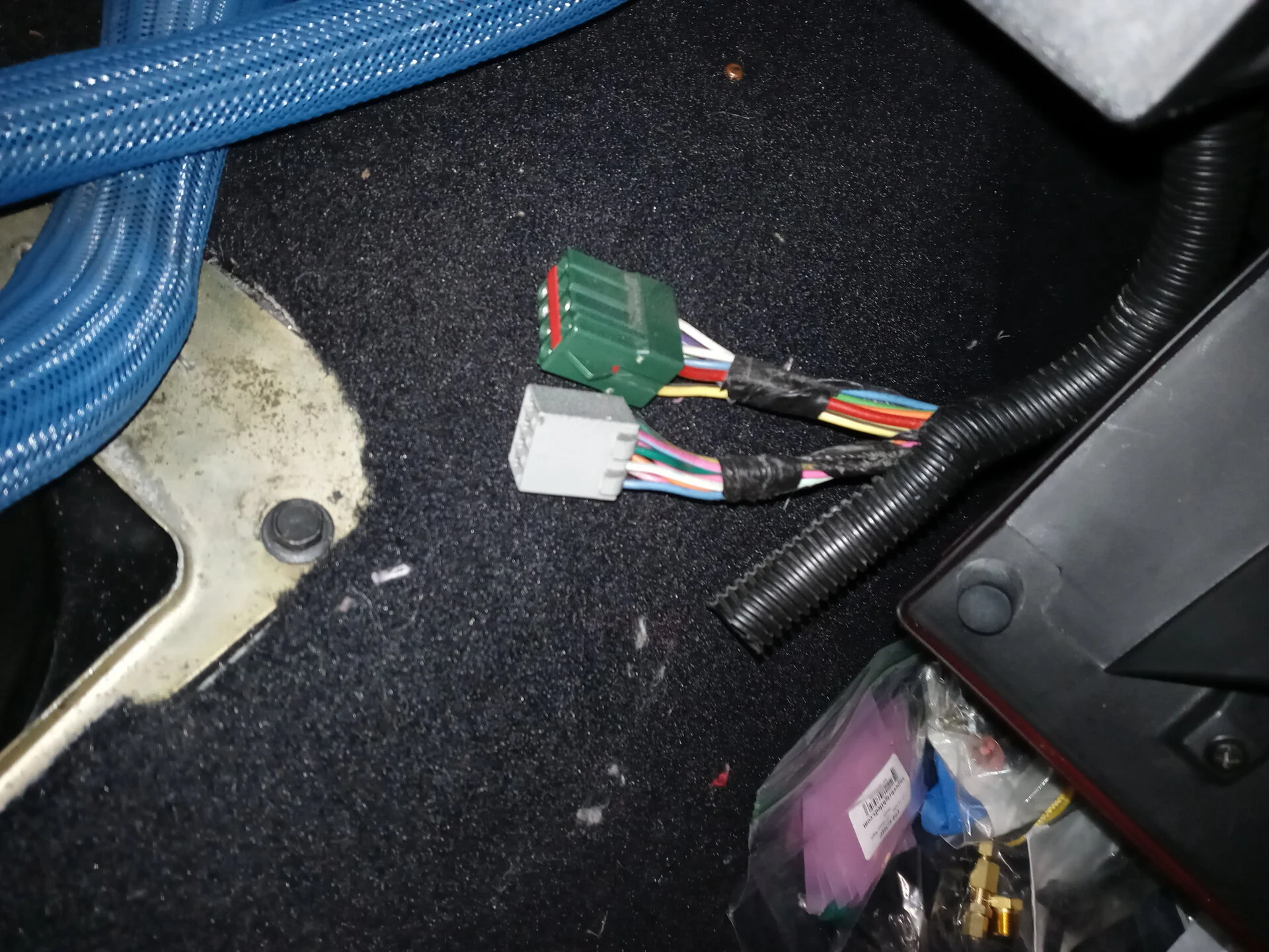

E ebone84 20+ Year Stangneter Jun 8, 2004 125 40 39 Jan 9, 2021 #1 Jan 9, 2021 #1 Still trying to make sure I didn’t miss a plug anybody know what these wires are or where they go to ....I’m hoping radio nothing with the HVAC Attachments 3CAB0DBA-5E88-4890-8CF5-D00698DFC43A.webp 325.6 KB · Views: 207
Dan02gt mazing how much gas smell came from that tiny hole 20+ Year Stangneter Mar 2, 2003 909 415 113 Greenville, NC Jan 9, 2021 #2 Jan 9, 2021 #2 Those look like the ones that go near the computer in the kick panel. I think some of the wires run the instrument cluster.
E ebone84 20+ Year Stangneter Jun 8, 2004 125 40 39 Jan 9, 2021 #3 Jan 9, 2021 #3 Not to long up under the radio headed toward the glove compartment.... i’m going to really stick my head up under there and see what I see ...
Mustang5L5 That is…until I whipped out my Bissell Mod Dude Feb 18, 2001 43,335 18,062 224 Massachusetts Jan 9, 2021 #4 Jan 9, 2021 #4 What year is the car? EDIT: 91 right? Looking at the evtm there’s a few possibilities. Wire colors of one of the plugs would help Last edited: Jan 9, 2021

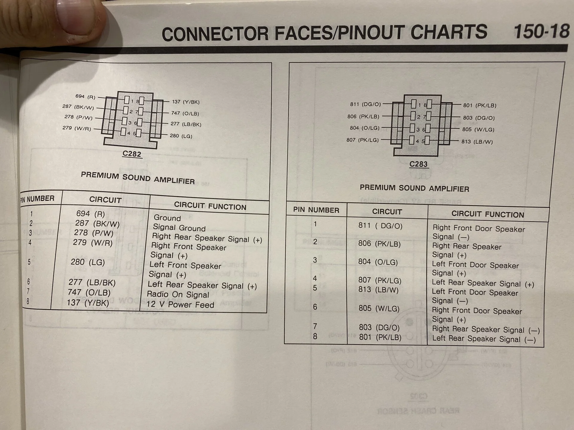

Mustang5L5 That is…until I whipped out my Bissell Mod Dude Feb 18, 2001 43,335 18,062 224 Massachusetts Jan 9, 2021 #5 Jan 9, 2021 #5 Do the wire colors match this?
