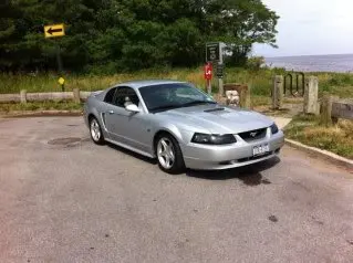

Hey everyone just picked up a new 35th anniversary editoin with 120k miles for 4700 on Thursday! I am pretty excited, because I have only owned 3 F150s in my lifetime. I know it is going to need brakes soon, but besides that would be on your top list for mods, knowing it has 120k miles on it. All it has now is a BBK Cold Air. Thanks
