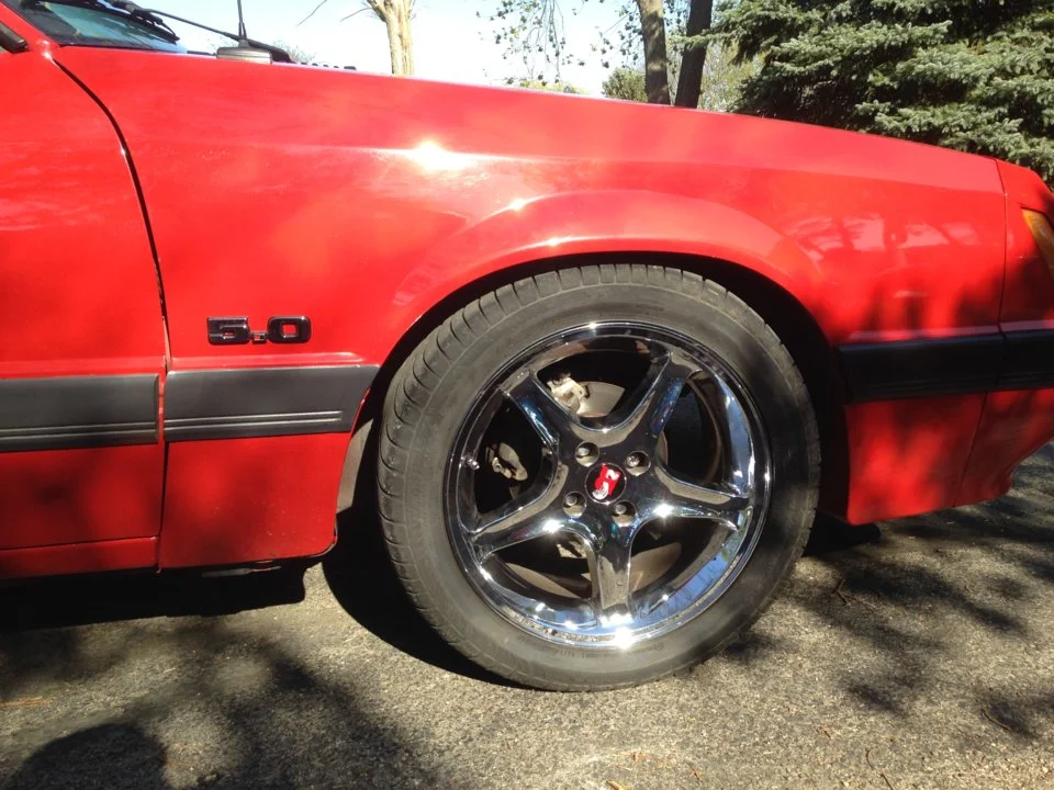

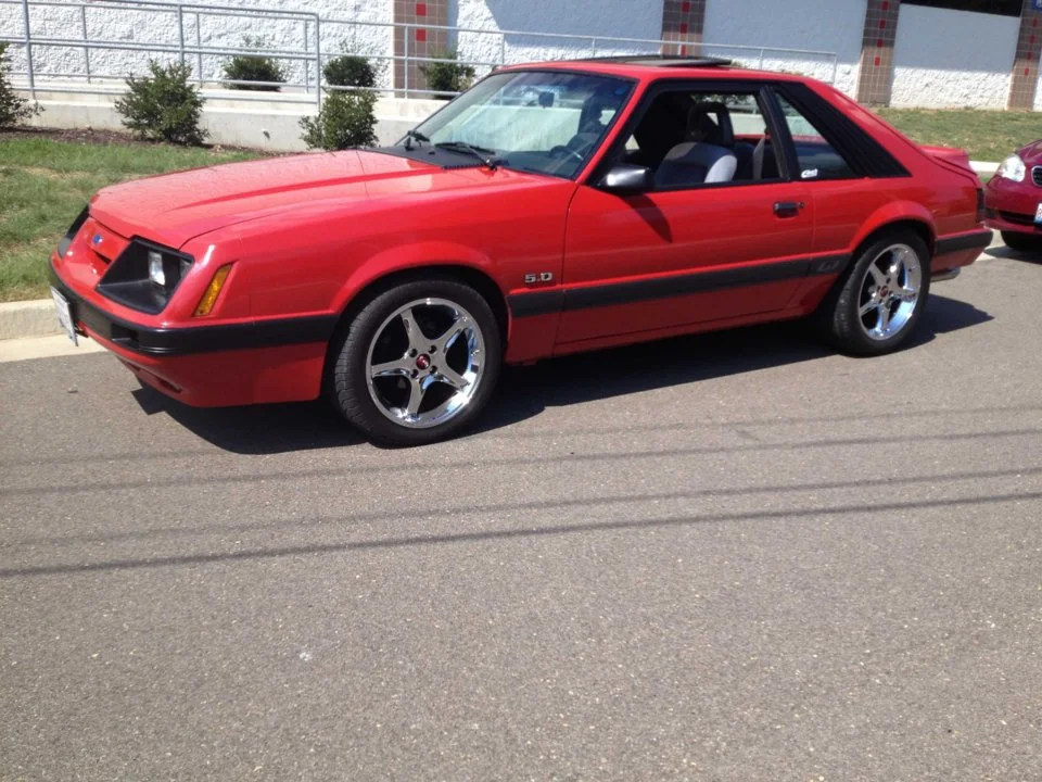

I just installed lowering springs on my '89. I have 275/40/17 rears on 17x9's and no rub. Lip is not rolled. Fronts are 245/45/17 on 17x8's. I have a slight rub on the front of the fender. I think I can trim it slightly and clear.

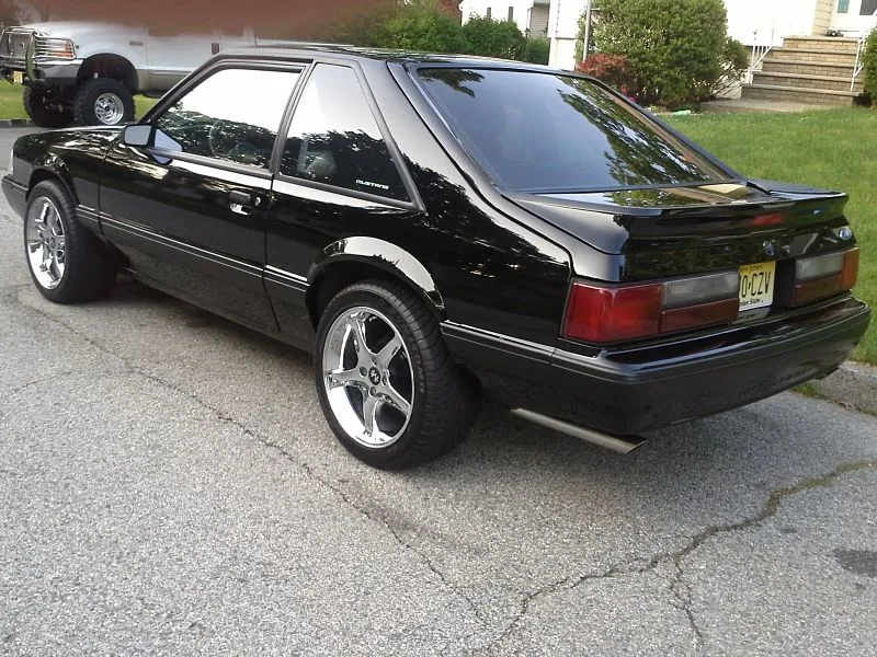

Mine are 275/40 in rear with a slight rub if I have people sit in back and go over a significant dip in the road. Wheel wheels are stock and I even have the quad shocks. I had removed them and decided to reinstall. I had no issues with/without them. Nitto's run slightly narrower than some other tire brands. You might have a slight rub in front if you use the 17x9's when wheel is completely clocked inwards(rub will occur on the inner sidewall if at all). Here's another front pic with coilovers and more than a 1" drop
