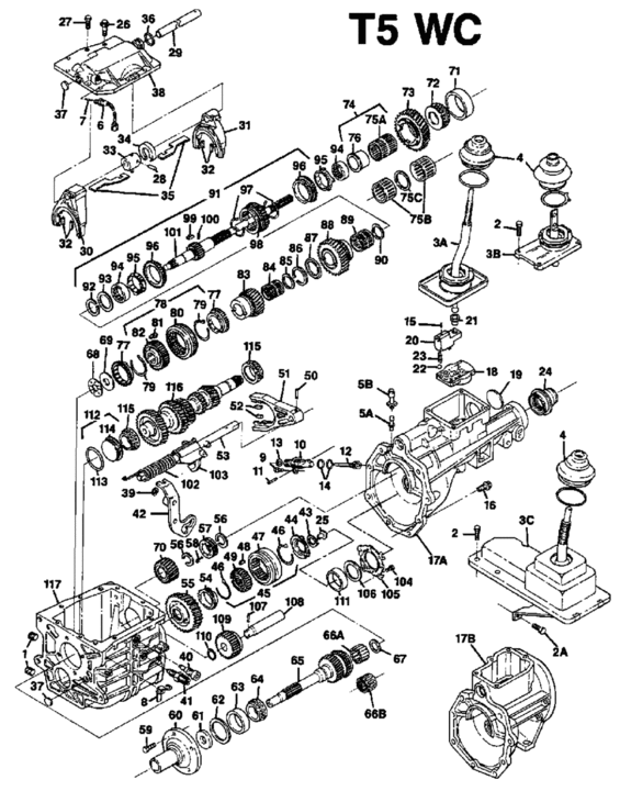

here maybe this might help you
http://www.hanlonmotorsports.com/HanlonTIC.html

In the 3-4 synchro assembly sleeve there are 3 keys resting on top of the syncro hub, if you dont get those 3 keys in the notches made into the syncro sleeve, you will have a difficult time shifting it into eithier of the gears. Check that to make sure they are in align let me know how it goes

This should be easy to figure out, especially with the trans out. First, make sure the shifter, forks and fork pads are installed correctly and in good shape. Make sure the lever can move the rails and forks.
If that is not the problem, pull the shifter and top cover and try moving the shift collar by hand. You should see what is sticking while doing this. As someone else noted, you have to get the three shift fingers in the synchro assembly installed correctly. This sounds like your most likely problem.
Make sure you have the endplay set correctly, although that should not directly cause your problem.
