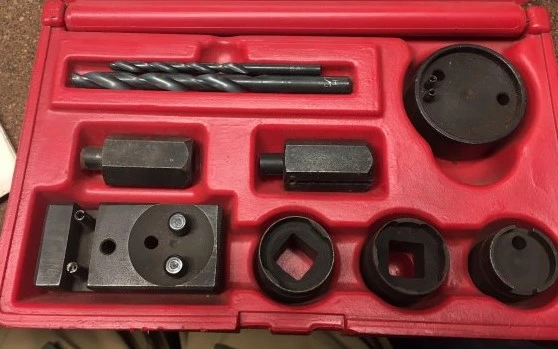

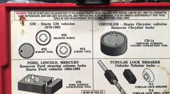

Yep thats correct so he is going to need a tool called a Force tool which I have from the old days when I used to repo cars in the late 80's/early 90's and banks didnt supply spare keys....LOL
A duckbill set of vicegrips and a blank key should get it turned so you can push the pin to get the ignition out unless its missing the wing then you need the force tool a cordless drill and a slap hammer...........Sometimes a slap hammer and a drill works too if you know where to put the bit and can drill perfectly straight..The tool is a jig and tthe holes are a drillbit guide to make sure the hole is drilled straight too..

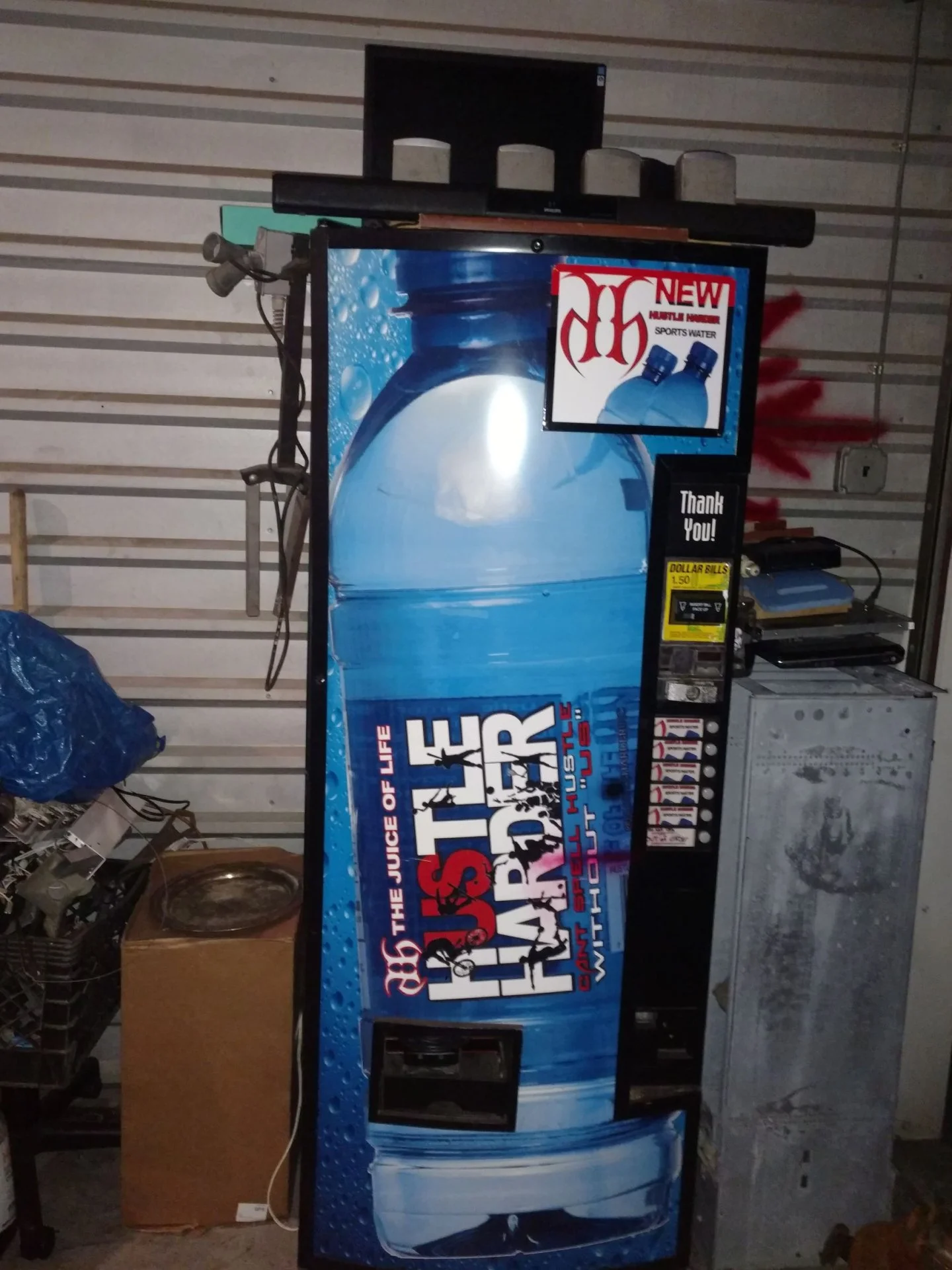

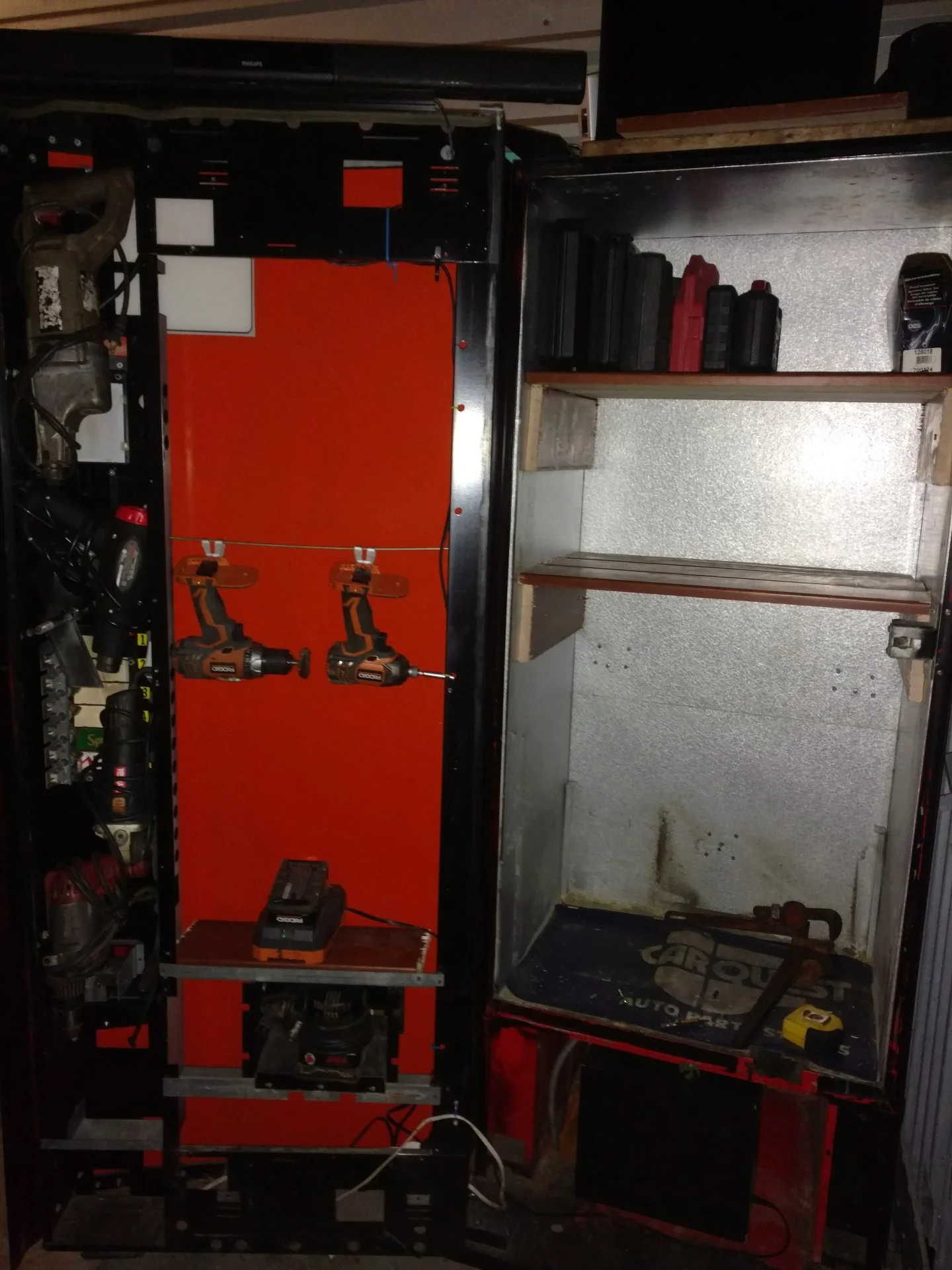

The tool was also good for cracking the locks on soda machines too...someone threw this one out without the key...
I cracked it open and repurposed it into a hidden tool cabinet complete with power station for the cordless tools and a 300watt sound bar w/subwoofer in the bottom and 4 satellite speakers on top...........LOL
