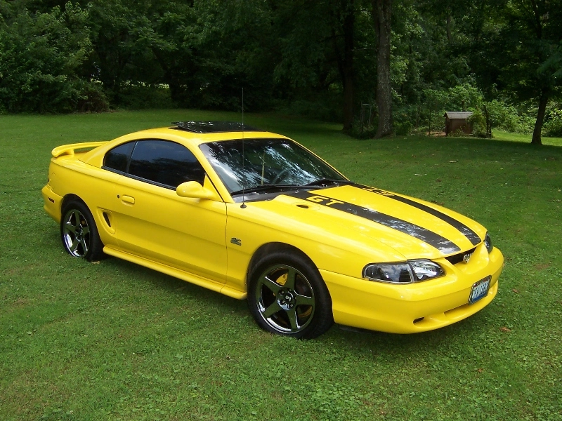

Well Ive actually done a little bit of paint when we were doing my fender and bumper. And I did pretty good for a first timer. Ive never done clear though. But I have wetsanded.

I don't remember what grit buffing compound we started with. It was some stuff my dad got from a professional painter and I don't think it was labeled...We did finish up with some 3M Finesse It I think it's called.
What I was told is to put on one or two thin coats of clear, then put on a thicker coat. I put on one thick coat my first time and it had a bunch of runs in it. We had to sand it down to the primer in a few places and re-clear the whole car after touching up those places.
