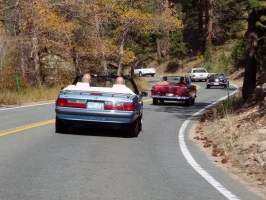

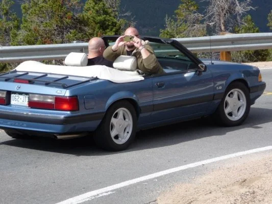

Here are a couple of pics of my car from last weekend
