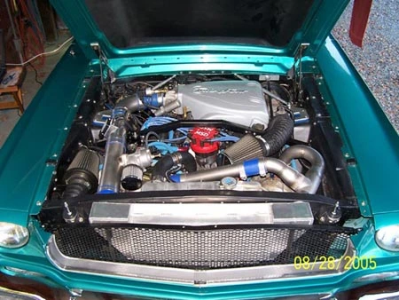

Yeah, There's definately a problem if he's got the 9PSI spring and it's hitting 15PSI. I was under the impession he had the 15PSI spring in there. I really doubt the exhaust backpressure is opening the gate tho. At least not by itself with the exhaust system he describes.
Is he using a 38mm Tial? If so, I kinda doubt the gate is too small. My 351W with 38mm Tial is holding 6-7PSI no problem, and I'm vented to the DP. His 347 probably makes a little more power, but is vented to atmosphere and I wouldn't expect to see this much of a difference. The problem he describes does not sound like boost creep. With boost creep, the boost will quickly climb to the target PSI, then will slowly climb as RPM increases. Sounds like his car is completely shooting past the target pressure.
Mario: Where is your WG reference signal hooked up? You sure you don't have the wrong spring or go sold a bad spring?
Would be so fricken nice if you had datalogs to post! :Zip2:

Could see the wrong spring in there. Just did a single 65 under a stock hood and the spring with a 10 psi spring and was supposed to be a 6. His is vented from both sides like yours. But i even have kits out there venting one side, like mine, and they work fine. But Marios vents both sides, which is really weird. Seen a few guys forget the signal line and have the gate open high.
