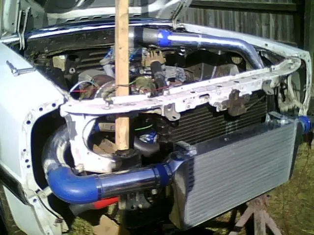

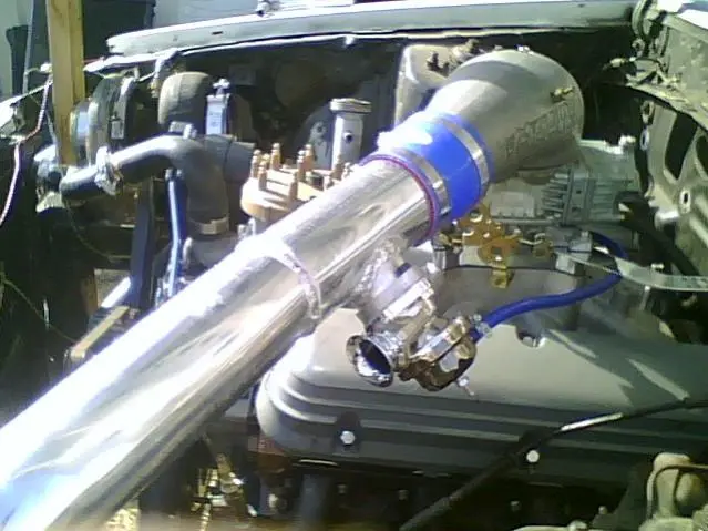

I have a Tial 38mm wastegate and a turbonetics manual boost controller and it said to boost reference from below the throttle blades.

Detonate with the bottle and the same thing will happen. ;)
Rich and i have an experiment going on in the next few weeks. I'll probably send you one, too.
Send me a pic of the inside of your wastegate, showing the inside of the valve stem clearly.
