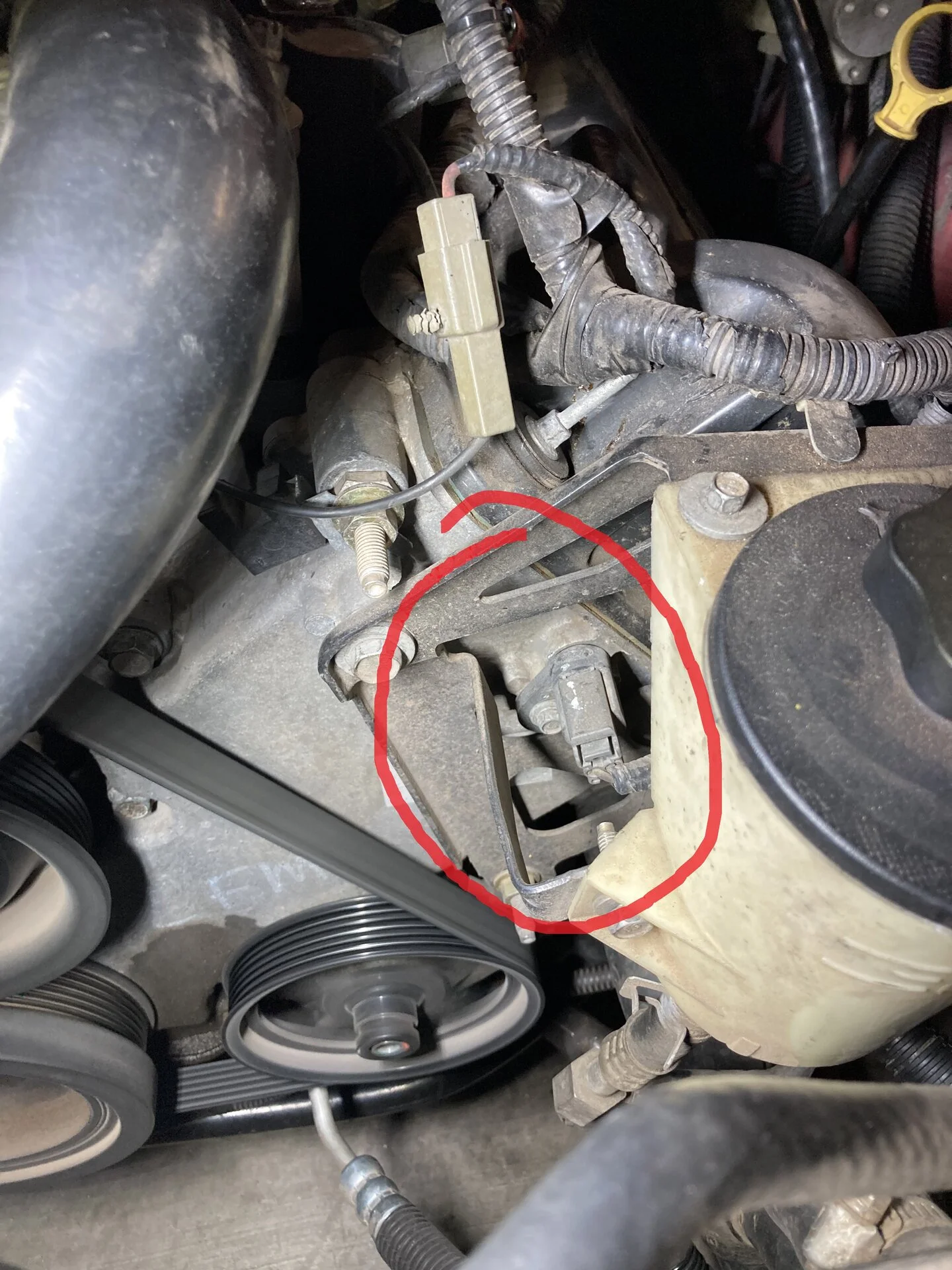

Using a breaker bar as a stethoscope, I found that the sound is coming from the driver side head, towards the very front(I believe it's were the timing chain is?)

I have three videos of the sound. The first one the engine is not at operating temp. The second video the engine is at operating temp. The Third video the engine is at operating temp and I used a breaker bar as a stethoscope and put the microphone against it to help bring out the sound. I also have a picture that shows where I believe the sound is coming from.

Sound location:
