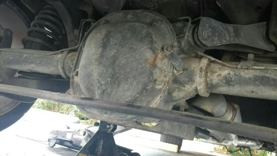

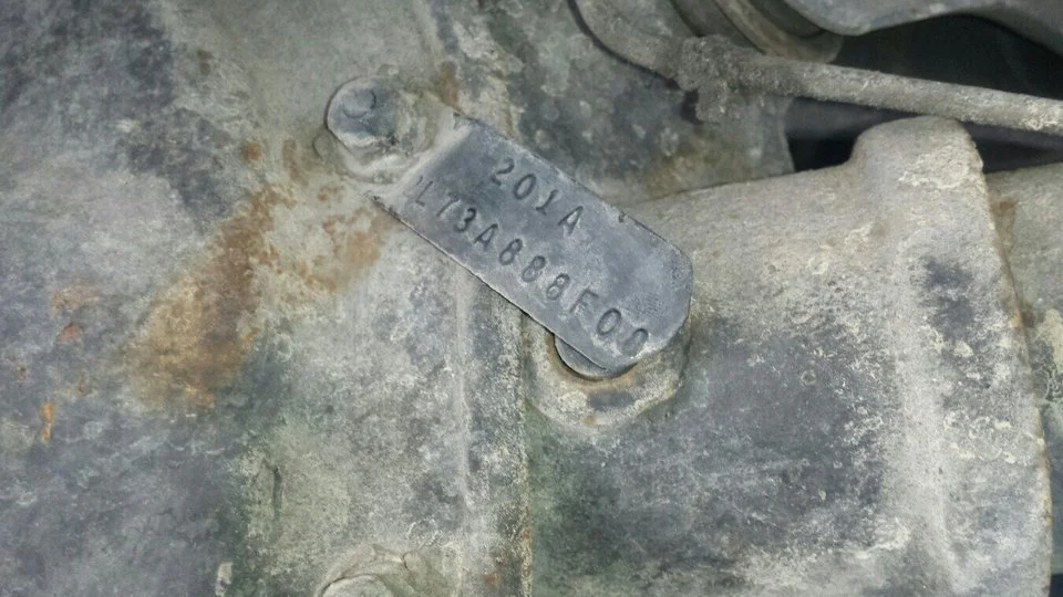

Check your diff cover as well to see if the tag is there. After you do the DS count check to make sure it matches the tag. It will say something like 2L73 or 3L08 etc
Look at the rear diff cover. It's a metal rectangular tag that's on one of the bolts. It will have a bunch of numbers on it and should the first few indicate the gear ratio. If you have 3.08 gears the tag will read 3L08...3L55 for 3.55 and so on. The "L" stands for trak-lok (limited slip). Be sure to not take the tag as truth. Somebody could have done a gear swap and not updated the tag.
2L73 YouTube video now uploading. Damn so I'm in for a treat when I order the 4.10 gear next week. And to think I already get 13.5 mpg (before and after laundry list of parts, side note, that doesn't make sense to me.)
