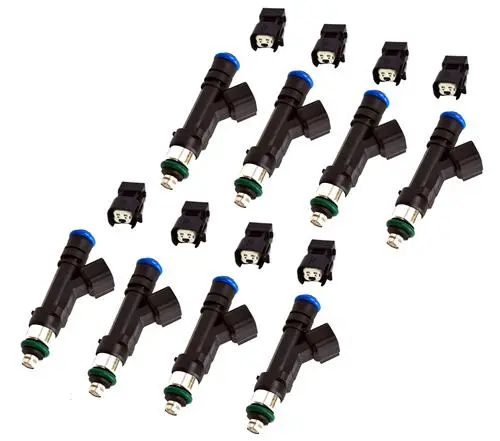

Those are the ones I'm using with a Vortech V3 at 10psi and Megasquirt. They come with the adaptors.I'm looking at LMR.COM and they have the 47#; those should run either a Vortech or Kenne Bell at base psi....what are your recommendations?
That's the ones I have, Ford Performance 47's. Uscar and Jetronic Capability. Includes Adapters.I'm looking at LMR.COM and they have the 47#; those should run either a Vortech or Kenne Bell at base psi....what are your recommendations?
