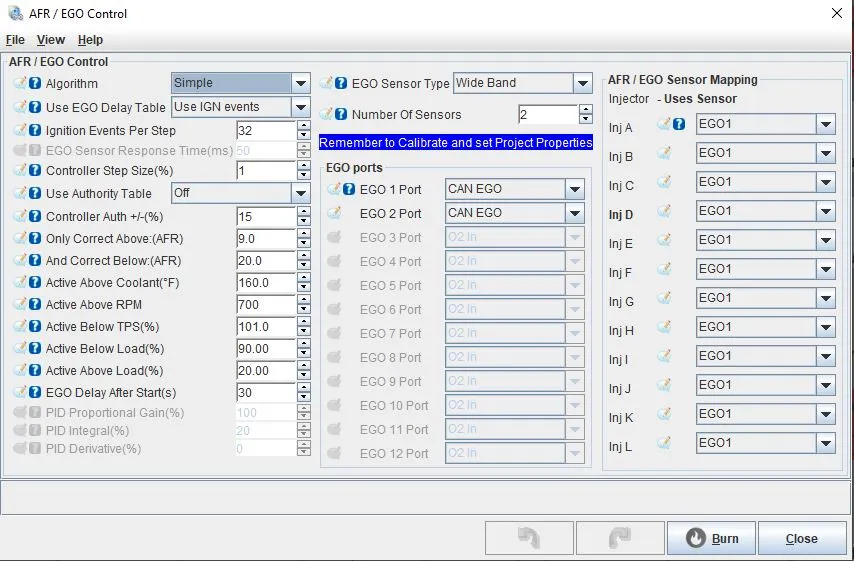

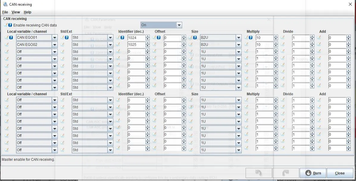

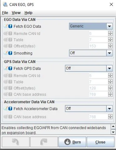

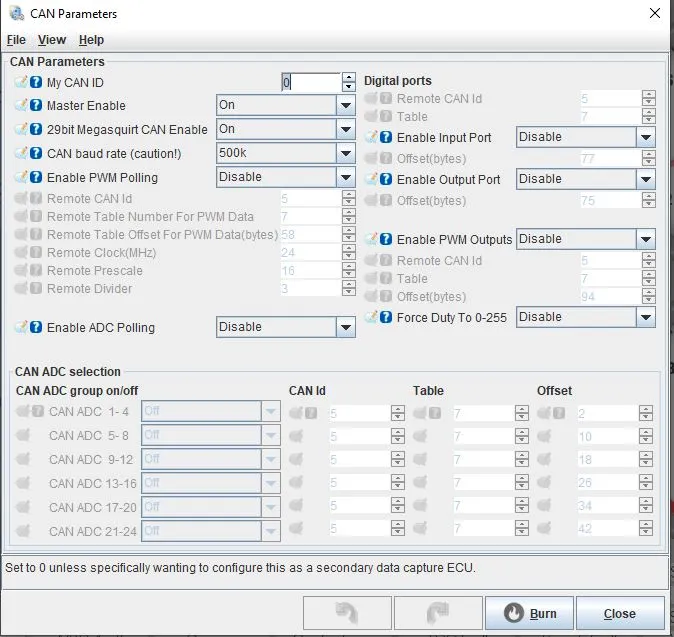

Hello-
I finished installing two 14point7 Adv 3 widebands. Bluetoothed in and set Baud rate to 500K and set ID on passenger side to 1025. I did all the settings per the pdfs on the 14point7 website. When running MS3 and tunerstudio both widebands read 7.8-8.0. Any ideas on what setting I could be missing or what could be wired wrong?
So I tried turning on 1 resistor then turned that one off then turned on the other and then turned on both still no luck. Using the Torque Pro App over Bluetooth the numbers look good. I guess my next step is unwiring one of them and getting a single one to work.
