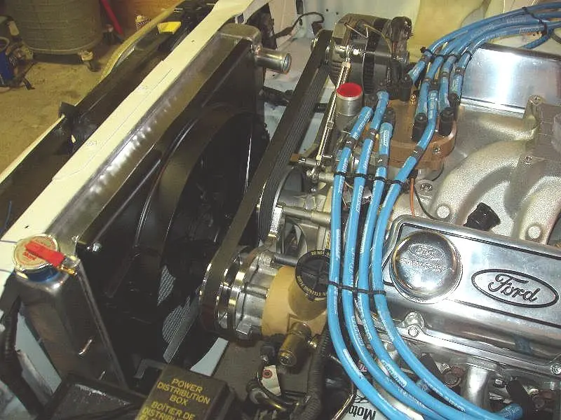

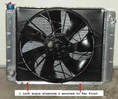

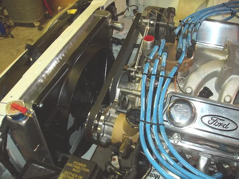

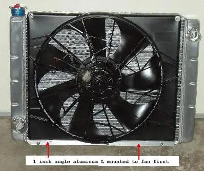

I am running a 393 stroker with under drive pulleys, and a 3500 RPM stall speed converter on the street. It has NEVER gone over 180 degrees. I am using (2) 24,000 GVW transmission coolers mounted in front of the radiator, so the heat from them is dumped into the radiator also. I am using a 160 degree stat, a Summit 2 row (1 1/4 thick cores) aluminum radiator, and a Mark VIII fan. The fan is set to come on at 180, and off at 170. The stock cooling system is working at it's max cooling a stock engine in the Summer.
Installed:
