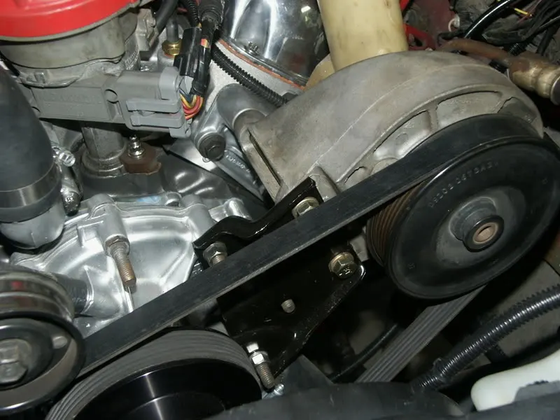

ac eliminator belt length
FRPP ac eliminator kit belt length is Goodyear 4060855 the 4060 845 that the stock 5.0 w/o ac calls for is too short. One reason may be the 3g alt upgrade on this car. The 3g I got first came with a smaller pulley (this 3g failed within 2 days the replacement sent to me had a slightly larger pulley, probably similiar to a UD pulley. If it had the smaller pulley the stock belt (4060845) would probably fit. This is my experience with this conversion. The rest of the pulleys are stock 1988 5.0 This kit was a breeze to install. :cool:
