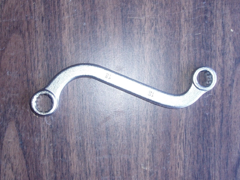

You can do it yourself, its not that difficult. I would drop the K-member though. I've done it both ways and dropping the K is the better way to go. And get a 13mm S-wrench. It makes getting to the top 2 center bolts on the passenger side a lot easier. Go here for a complete article on the install

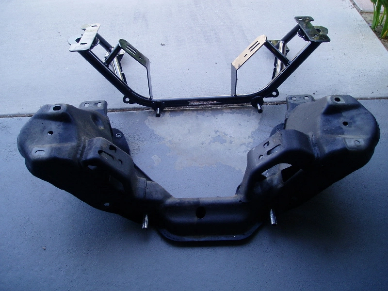

I don't think you will need an alignment if you drop the K-member. When I dropped my K-member to install my BBK shorty's, I put in an aftermarket PA Racing Tubular K-member. I did need an alignment after I installed the tubular one.
