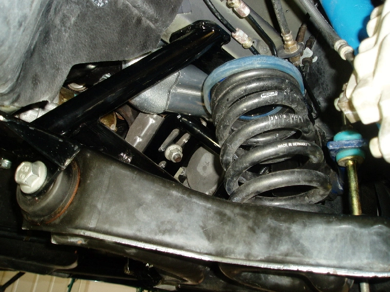

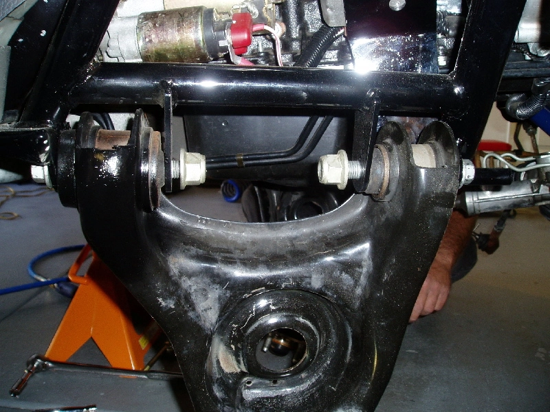

Got my K-member here http://paracing.com/
No help to your suspension
It definitly gives you more access to the underside. Not sure about the dirty part.
I got mine delivered to my door in Cali for $395.
Shipping label on the box mine came in said 20 lbs. I didn't weigh the stock one but, it is definitly heavier.
I used my stock A-arms and my current suspension, see sig.
