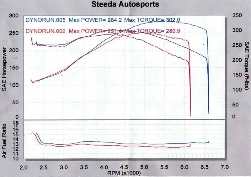

Here's my VT Stage 1 Dyno if this helps anyone...

DerekStangGT said:
yeah, it helps. what were all your mods? and was that before/after just the cams?
Yes, that was just the cam install. I gained 33rwhp and 13rwtq with the cams. My mods: Steeda CAI, Accufab TB/Plenum, Steeda Intake Spacer, Steeda T/A, Steeda Pulleys, VT Stage 1 Cams, Bassani O/R X-pipe, Steeda Cat Back, 3:73's and a Superchips tune.
